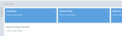

Since about 10 days agora SCI is not finding controllers. We have one ZD3000 and a vSZ does someone know how to solve this?
From the side of the controllers, they are connected to SCI.
vSZ :
thanks in advance.

This issue may happen due to many reasons as mentioned below:
1. High disk usage.
2. Storage might be high.
3. We may need to restart the docker.
4. We may also need to Increase leap size. ( depending on the issue we see ) or We have Incomplete edit files processing.
5. Could you please confirm do we have any events like Disk usage is high ? Navigate to Admin > Status and Update > Check for Notifications if we have any such.
6. We may need screenshots of Spark Master, HDFS, Druid Coordinator, Druid Overlord from Admin > Diagnostics ( which will also give an idea on why the issue started )
This depends on the command outputs and the information mentioned above so that we can proceed with the procedure to solve or fix it.
