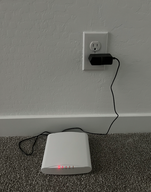

I have two Ruckus R510 Access Points in my house. One of them is working fine and the lights are green. The other one is stuck with a red light on the PWR indicator. I tried resetting both my modem/router as well as the switch and nothing is working. I even tried to factory reset the Access Point, but not matter how long I hold the reset button it just remains red constantly. Also, the POE light on the back of the AP is showing a amber color as well as on the switch for that AP.
On the unleashed dashboard it is showing that it is disconnected.

We kindly request that you connect your RUCKUS R510 Access Point (AP) to a functional power outlet and share both pictures and a video showcasing the light status, the cord connected to the AP, and its connection to a working power outlet. Please refer to the example pictures provided below for guidance.

Hello. I have uploaded the video to the above link. How do I upload the photos? Each time I try to add them here it says file type not supported. Thank you.

Hi @User123456789
Thank you for the response and the Pictures/Video.
Based on the troubleshooting done, and you confirm after performing the reset of the Access Point, and checking all the connectivity and connections, the failure persists. And this is the only ONE access point that isn’t working with Red PWR LED on it even after checking with an external power adapter it behaves the same. This ONE Access Point Unit Should be RMA (Return Merchandise Authorization) in simple words replacing it.
