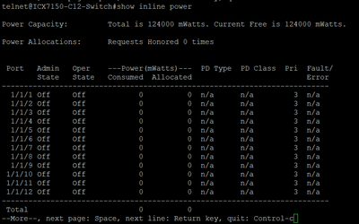

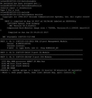

Good morning. I was following another thread with a similar (No PoE) issue. I used PuTTY to find the Router data and it looks like this:
It appears that no power is going to the ports.

From the case description, I could understand that your PoE is in a disabled state and you’re unable to get the power to your Access Points.
As I can see from the pictures you shared, the PoE is in the disabled state on the Switch. By which the Access Points are unable to get the power.
To enable the PoE on the Switch, please perform the below commands from the CLI:
Switch>enable
Switch#configure terminal
Switch(config-mif-1/1/1-1/1/12)#inline power
Also attaching a Screenshot as a reference:
Thank you again.
