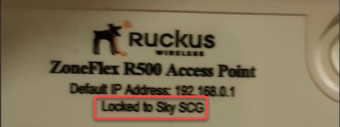

I think I've found the cause. It says on the back of the AP "Locked to Sky GCS".
I presume this means there is no way of unlocking it.

paul_van_der_cr
Contributor
Hmm... looks like a kind of special build to me, never seen this beroer, but I know Sky in the UK is a big Ruckus customer.... where did you get this AP?
