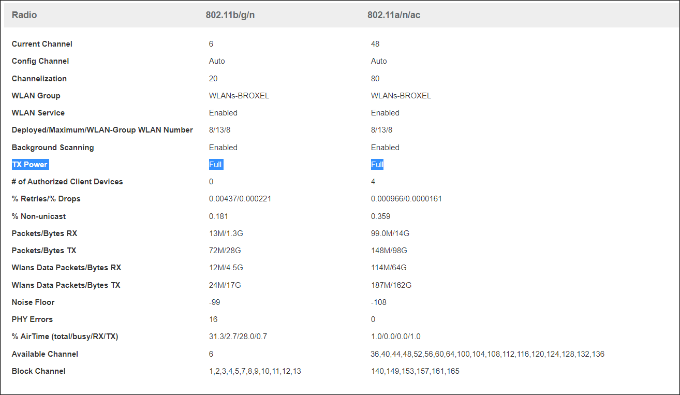

I have 12 Ap´s in a ZD1200. All transmit to the maximum in auto
Image_ images_messages_618379cc3a5e841cb23a8590_5a0b28a9ffbbc5fe59d2c05735b17114_Snap20211104at00.12.00-99cbcb78-8fdc-4074-914c-bce34064fd27-1648183240.png
