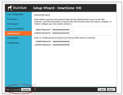

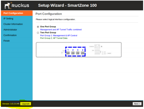

You will need to factory default them again and then when you run the second setup (cluster create or join) you will see the upgrade button on the bottom ... this is an unconditional upgrade that allows you to install any version:
Image_ images_messages_5f91c47e135b77e247ab8fbd_e5cb888a689e3384f00ae948bc265f47_RackMultipart202002181010031hs-f629240f-7443-47db-9263-2d9603f78fa3-1458496139.png1582056541
Image_ images_messages_5f91c47e135b77e247ab8fbd_4b6f999c353cb0f45205a6b681615ee5_RackMultipart20200218106571t3h-0751783d-efaa-4229-a06a-a8e8a2404a1b-2053203334.png1582056574
I have not setup a 5.2 system but as far as I know this feature should still exist.
I hope this helps.
