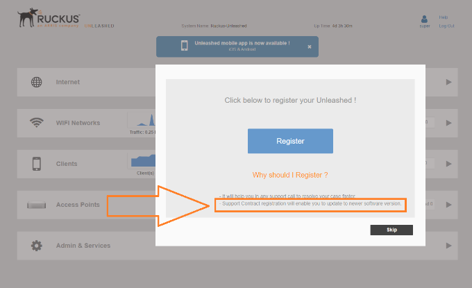

Today I got a brand new C110 out of the box. Put it on the work bench to see if I could recreate the firmware upgrade issue that I am having on my production C110.
I flashed UNLEASED C110_200.6.10.1.308.bl7
Then reset to factory defaults by holding down the HARD RESET button for 20 seconds.

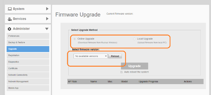

Now, both my bench C110 and the production C110 have the same issue. I cant upgrade the firmware any further. All the upgrade options are grayed out.
