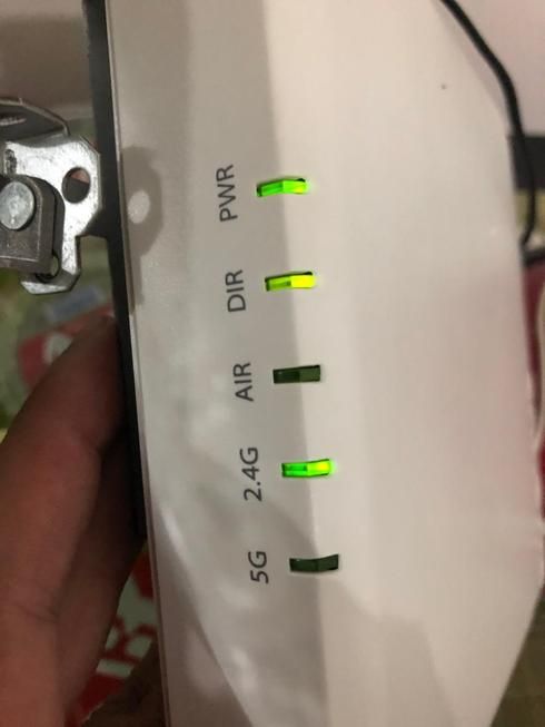

Dear All Forum Members,
I have Ruckus R600 with unleashed firmware. The problem is Radio 5Ghz is down. What should I do for bring up Radio 5Ghz becom online.Image_ images_messages_5f91c3f8135b77e247901951_a7118e64fba35a524e61fca095df5482_RackMultipart2018122151692o1sq-9d099f64-e86d-4a8d-88d6-e810edb46f19-1572072380.jpeg1545407584

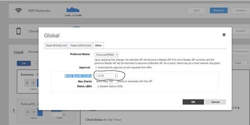

And one question again. Why I can`t change Model Specific Control C110 to R600 on Unleashed Dashboard.?
Image_ images_messages_5f91c444135b77e2479f659a_d11ba15317352f906787a0e8c1318a48_RackMultipart20181221687651no4-d777fdd9-6e34-4a49-8eb8-5f9aafb09ed2-941022503.JPG1545410244
Thanks for all attention.

The 5GHz radio would be down if it wasn't configured to transmit an SSID.  If you have done this and the 5GHz radio still won't come up then I would recommend doing a factory reset using the button on the underside of the AP and then upgrading to the lastest version of Unleashed (if you aren't already).
Regarding the model specific control, I've just checked on my Unleashed R310 AP and can select any model.  This may indicate that something isn't happy with your AP and you need to run through what I've suggested above.
