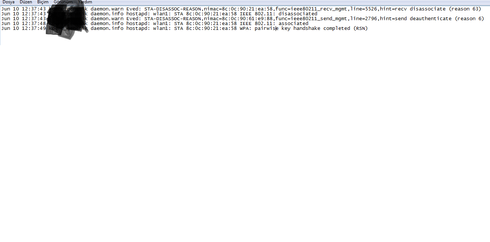

i am using ruckuss 7731.Root and non-root bridges.Distance is 270 meter.
But they disconnection suddenly over 10 second in 3 hours
it is log
attachment.
i know there are too many devices around.
Non root Bridge Rts/cts thresold: 65535
root bridge rts/cts threshold : 256
non-root rx rssi : 42 ack rssi: 47
root rx rssi : 39 ack rssi: 48
Maximum required trafic 50 Mbps.
should i change Rts/cts value for solution problem?
What can i do ?
Can you help me?
Thank you very much for your help
it is log
What can i do ?
Can you help me?

You have very good signal strength. The NRB logs show a dissassociate with a reason code of 63 (reserved), that I don't recognize.
Reason code 6 is Class 2 frame received from non-authenticated STA (ok).
What channel are you using? I wonder if there has been some strong temporary interference.
Have you set the Distance on both sides?
Can you try running the Channel Optimization and see if it selects a different channel this time?
See the 7731 User Guide here: https://support.ruckuswireless.com/documents/196-zoneflex-7731-user-guide

i using 108 channel with smartselect option.
i set 2 Km distances.
According to log,what do you think problem ? do you thinh it is interferenced?
Would you recommend that i use the "Wireless spectrum analyzer " program? İf yes,Which antenna side do i use? But you dont think interfecerenced ?
i am so confused
i am so confused

today i had the same problem again.
The non-root bridge and bridge log is the file is attached. Logs are always the same.
i tried smart select options and then manually change the channel. But the problem still is not solved.
- According to the logs, How do you i know which antenna side a lot of broadcasting?
- Should you offer a free third-party wireless analysis program?
- According to the logs, Which antenna should i try with this program?
- According to logs is the path, the method i followed is it true?
- What do you suggest after analyzing them?

I don't have access to hardware... Please open a ticket with our Tech Support, who will dig deeper into the logs, and can do better research, thanks!
