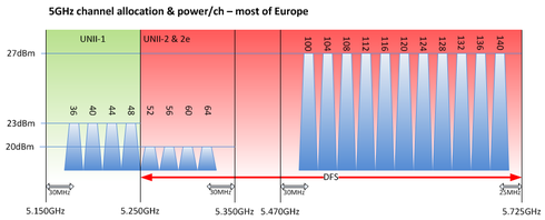

I would agree with @Steve_Buyrum, however one must understand that allowed power output on non DFS (UNII-1) is only 200mW (23dBm) which is lower than on UNII-2e which is 500mW (27dBm). At least in the EU that's true.
If you can live with this ok, otherwise buy a higher gain antenna.
Image_ images_messages_5f91c416135b77e247959a7f_67a4c0818908d9a90b10190c7d2a9954_5GHz_moci_inline-f2eeb6e2-74d5-4b5a-8822-23a68630ac16-2128637197.png1389687610
