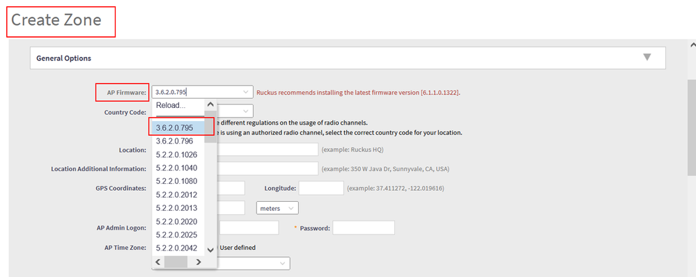

The advantage of the SZ controller is that if you need to upgrade to the newest version 6.1.1 (whether to onboard one of the newest AP models or for some specific feature you want to implement), you can still keep the EOL R700 AP on a separate AP Zone with the firmware 3.6.2.0.795 for this zone, while the newer APs are managed in zones with the appropriate version for them.

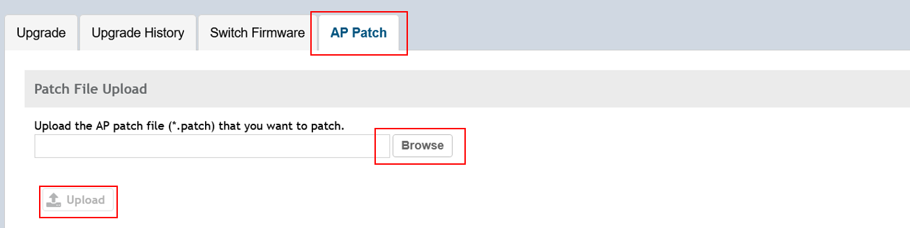

You can add this AP firmware version with the AP patch for this purpose:
You can download the 3.6.2.0.795 patch HERE
- Upload the AP patch at Administration>Upgrade>AP Patch
- Create a new AP zone and select firmware 3.6.2
