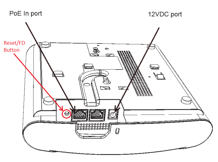

R series
In R series Ruckus has many different AP models and though physical layout may look different for each AP, reset button is always located near the ethernet port or in some APs near the USB port.
One thing to note, in R series APs there will be single Reset button. Pushing the button just once and releasing it will do a restart (power cycle). Pushing and holding the button for 8 seconds or more will factory default the AP settings.

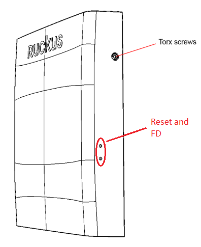

H series
In H series APs you will find two separate buttons. One for "Reset" (Reboot the AP) and other for Factory Default (FD).

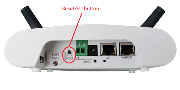

M series

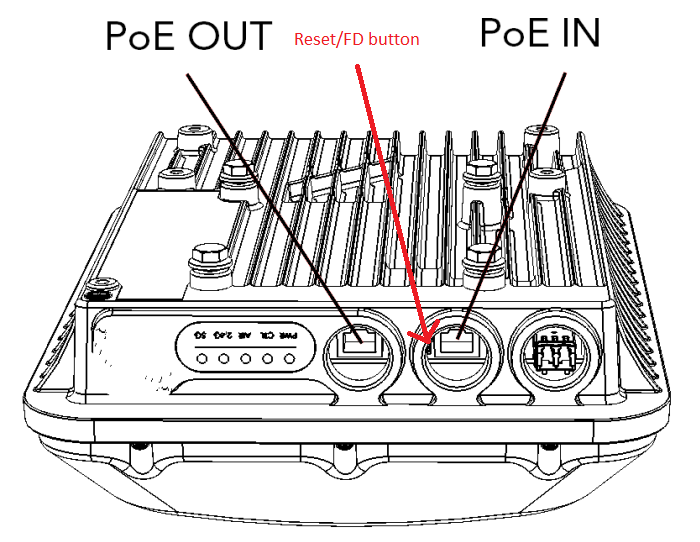

T series (Standard Outdoor)
You can reset the AP factory default settings by pressing the reset button behind the access plug covering the Ethernet port (PoE IN port).
Note: Your AP layout may look different but reset button is always hidden inside the PoE IN plug covering the Ethernet port for all Ruckus outdoor APs.

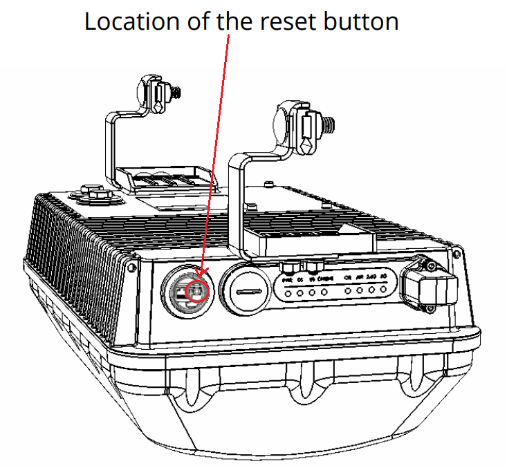

T series CM (Outdoor - Cable modem)

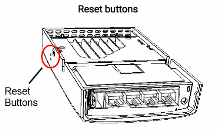

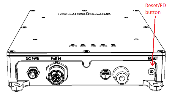

E Series (Embedded)
Note: Remember to replace the Torx screw covering the Reset button after use. Insert the screw and torque to 4 in-lbs.
