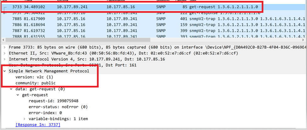

SNMPv2 trap troubleshooting: To troubleshoot and isolate if the polling and trap are working good use the Wireshark to run Packet capture in the uplink of the switch or on port which falls in path of traffic that helps lead the traffic to monitoring tool.

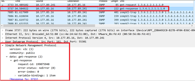

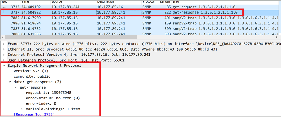

SNMPv2 request from SNMP tool:
SNMPv2 response from Switch:

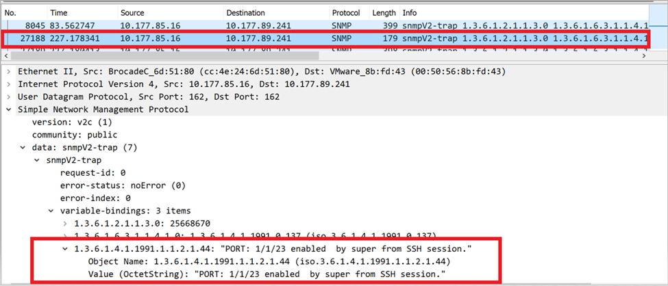

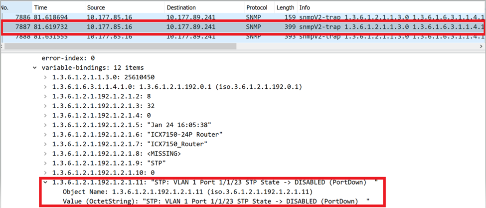

SNMPv2 Trap Response from the switch:

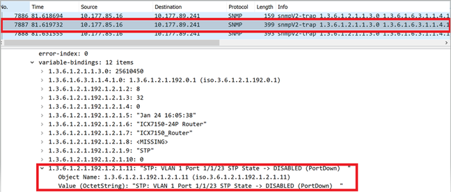

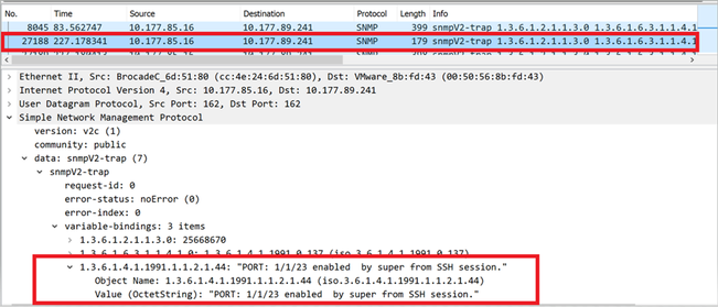

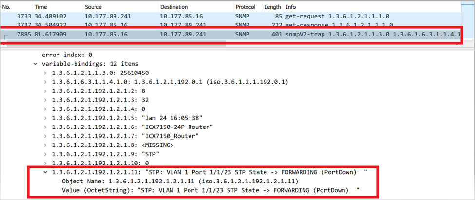

Here port 1/1/23 is disabled and enabled to generate SNMPv2 trap:
Port disabled:
Port Enabled:

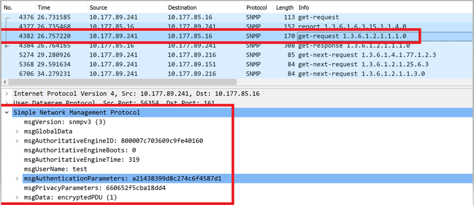

SNMPv3 trap troubleshooting: To troubleshoot and isolate if the polling and trap are working good use the Wireshark to run Packet capture in the uplink of the switch or on port which falls in path of traffic that helps lead the traffic to monitoring tool.

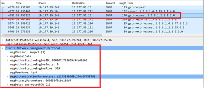

SNMPv3 request from SNMP tool:

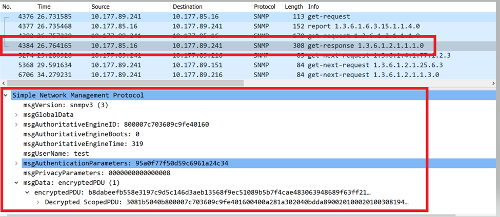

SNMPv3 response from Switch:

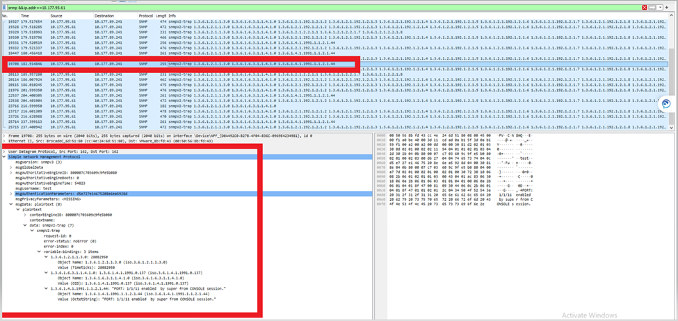

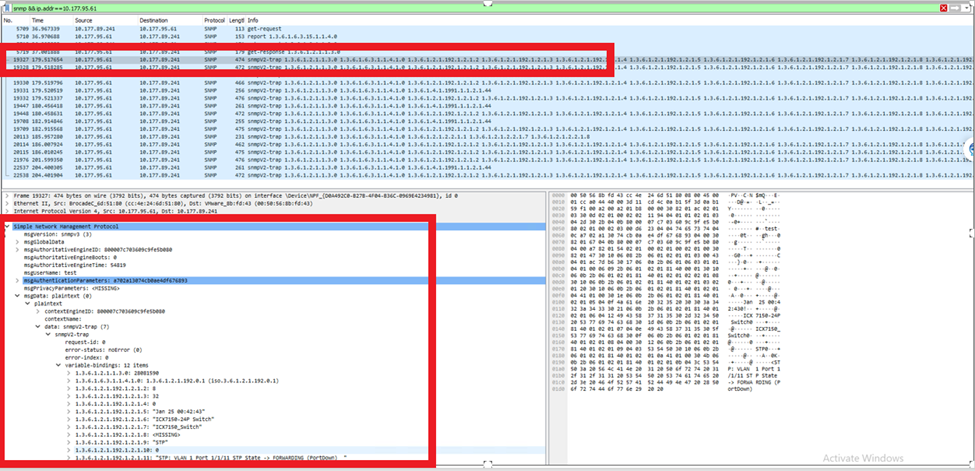

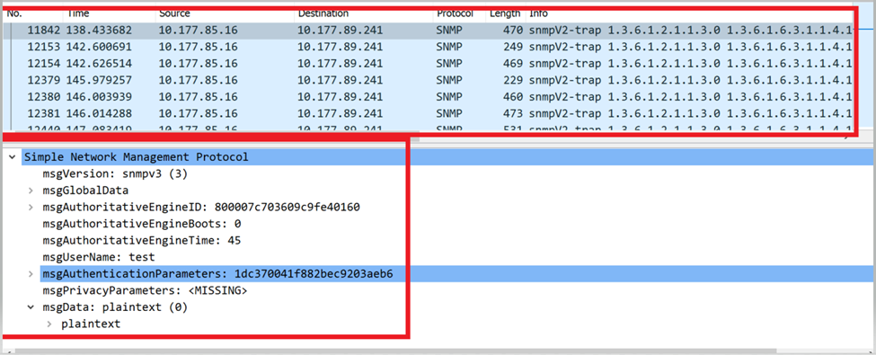

SNMPv3 Trap Response from the switch:
Here port 1/1/11 is disabled and enabled to generate SNMPv2 trap:
Port disabled:
Port Enabled:

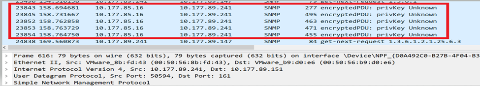

When the SNMP packets are not decrypted it would look like below

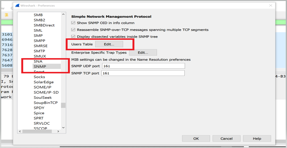

Steps:

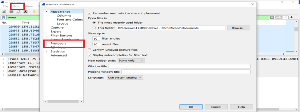

- Go to Edit > Preferences > Protocols.
- In protocols go to “SNMP” -> Edit “User Table”

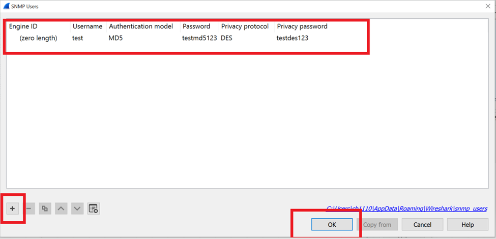

- Click on “+” and add SNMPv3 details like Username, Authentication and privacy method and password
Once the details are added the decoded SNMPv3 traps would look like below picture in Wireshark
