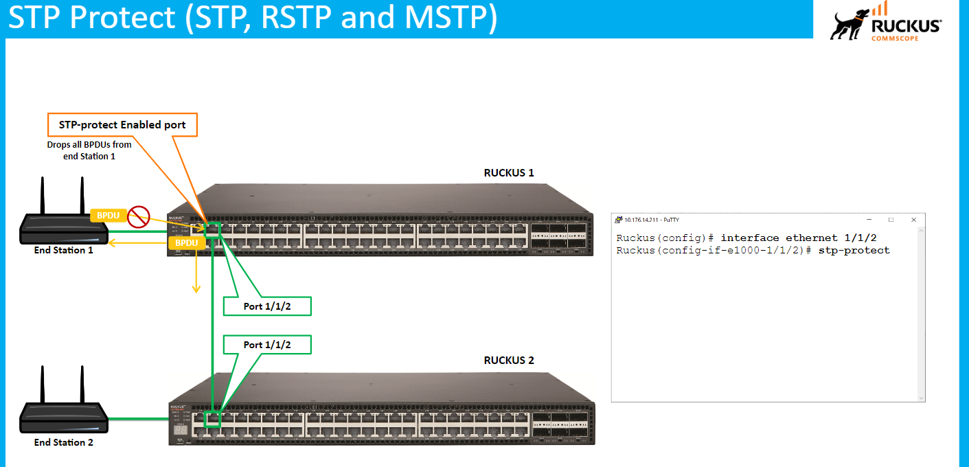

STP Protect is designed to enhance network stability by causing a port to drop STP BPDUs originating from the device connected at the other end of the link. The primary function of this STP protection is to prevent end stations from either initiating or engaging in changes to the STP topology. This feature is crucial for maintaining a consistent and stable network structure, especially in environments where end stations should not influence the network's layout or data flow paths.
STP Protection Enhancement https://docs.commscope.com/bundle/fastiron-09010-l2guide/page/GUID-A4F0188F-A7FE-49D3-A79D-5E48AC481E0E.html

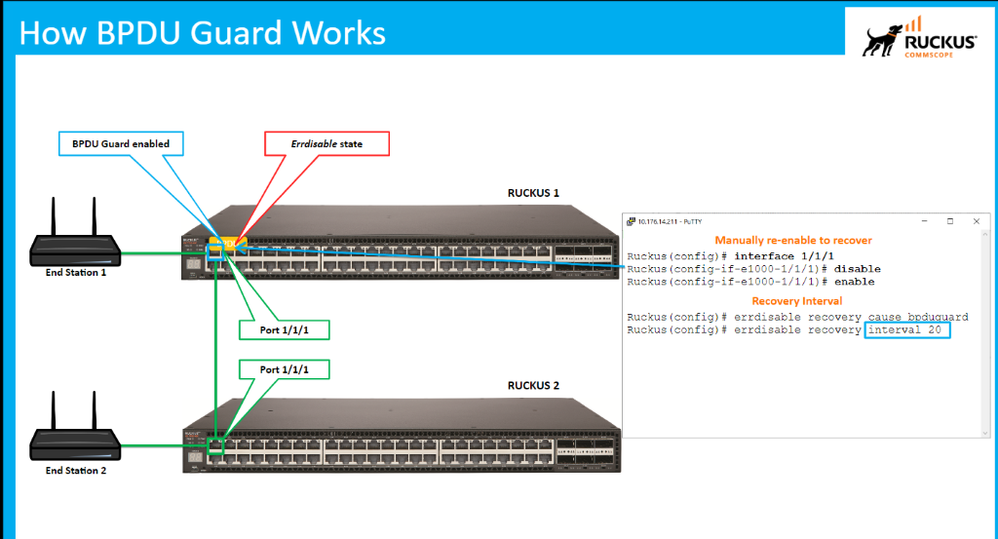

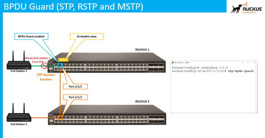

The BPDU Guard feature is a security measure in Layer 2 Spanning Tree Protocol (STP) networks, designed to defend against BPDU-related threats and prevent accidental misconfigurations. When enabled on an access port, BPDU Guard ensures that if a BPDU is received, the port will enter an error-disabled state. Recovery from this state requires a manual shutdown and restart of the interface or configuring an auto recovery.
Re-enabling ports disabled by BPDU guard : https://docs.commscope.com/bundle/fastiron-08090-l2guide/page/GUID-072E446B-D157-4815-8C02-E5EA4D2D50C8.html
Enabling an error-disabled port automatically : https://docs.commscope.com/bundle/fastiron-08090-l2guide/page/GUID-5B6686B1-CAAB-44FA-B2EB-2854B0805950.html

As Summary STP Protect concentrates on ensuring the stability of the STP network. In contrast, BPDU Guard serves as a security feature that safeguards the network against detrimental BPDU packets. This protection helps prevent complications such as STP loops and unauthorized alterations in the network topology.
