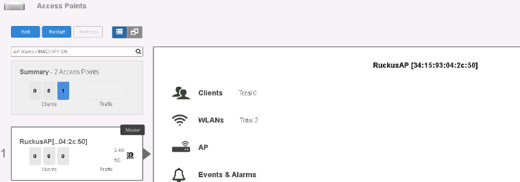

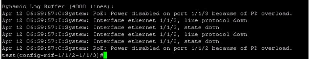

APs are working fine with power-by-class 1, however, if the Poe device needs more power, it will reset and will trigger this PD overload log.

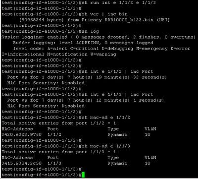

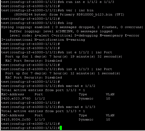

show inline power emesg
Show log
Show inline power

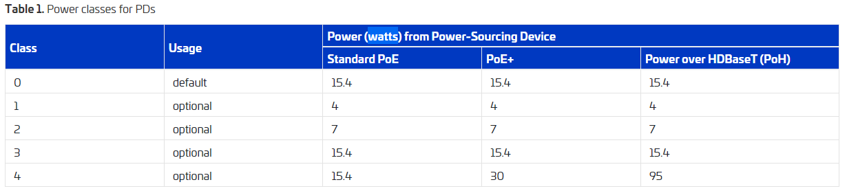

According with this document
https://docs.commscope.com/bundle/fastiron-08090-managementguide/page/GUID-66F38E0E-A4D5-4683-B5A8-746D22954212.html
And since the Poe devices needs more power, they go to the state
The solution would be to adjust the configuration at the port level configuration mode
The solution would be configure the port with the right power class.
test(config-if-e1000-1/1/2)#int e 1/1/2 e 1/1/3
test(config-mif-1/1/2-1/1/3)#inline power power-by-class 3
