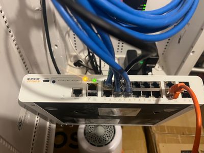

Post the power outage today, my ruckus wifi is not working.
there is a light in the ICX switch but no power light in all the three APs.
My internet is working thru my provider.
enclosed are the pics of the ICX swithch and API
Hi @roopeshgupta
Hope you are doing well!!!
As per the case description, I could understand that your RUCKUS setup is not working after a power outage, and Access Points do not have power.
Please note, I see from the picture you shared, seems like the ethernet cable which is coming from the Router or Modem/Router combo is plugged into the wrong port on the Switch panel. It must be plugged into any 1 in-12 ports as shown in the below screenshot. Please unplug the ethernet cable and plug it into the correct port.
As I can see from the picture you shared, there are lights on PWR and SYST, if there is an amber/orange light on the "SYST" and a green light on the "PWR" on the Switch (as it is in the below picture). Meaning the Switch is stuck in the boot mode.
Basically, due to the power outage/ power spike, the switch went to a state that we call ‘boot mode’ that is not able to boot up properly.

The router cable was plugged in where it was in the picture before power outage and was working fine. Based on your suggestion i plugged that wire in port 1-12 and tried to reset it. It was constantly in the mode where lights were flashing.
then i plugged the router cable again in the port where it was and again did the reset and this time it worked. I remember previously also when a technician came to home and tried moving the cable to port 1-12 it didn’t worked. This is making me think whether there is any issue with the switch itself and does it need replacement as it gives problem everytime when there is power outage
Please note, this issue happens repeatedly when your Switch is on a old software version and to avoid the same we may need to upgrade your RUCKUS ICX-7150-C12P Switch to a new stable version.
