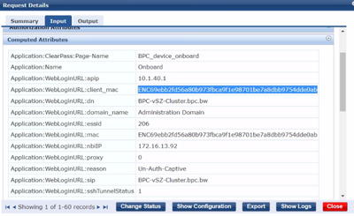

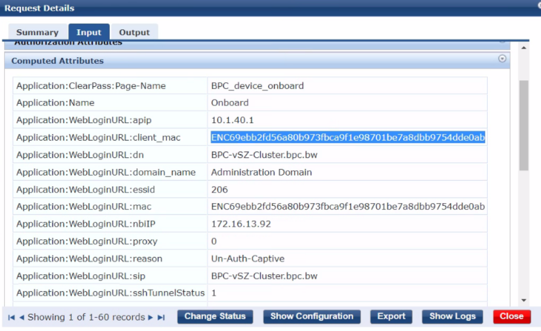

- On the Clear pass >>Access Tracker we found that the client MAC address is in the encrypted format instead of its original MAC.

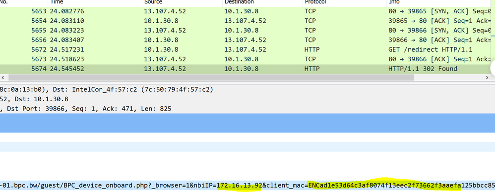

6. On the client-side Wireshark Packet capture , we found that the client is getting redirected to captive portal page with HTTP 302 redirect message, here as well the client mac address is in the encrypted format.
