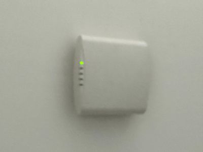

I can’t figure out how to get the connect.me to show up in my network options. Could someone please help me?

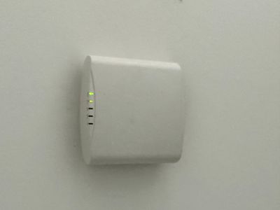

No I am not connected! I still can’t can’t figure out how to get internet connected to ruckus. The pictures I sent before were before I unplugged the old internet. Here are current pics.
It blinks between those two
