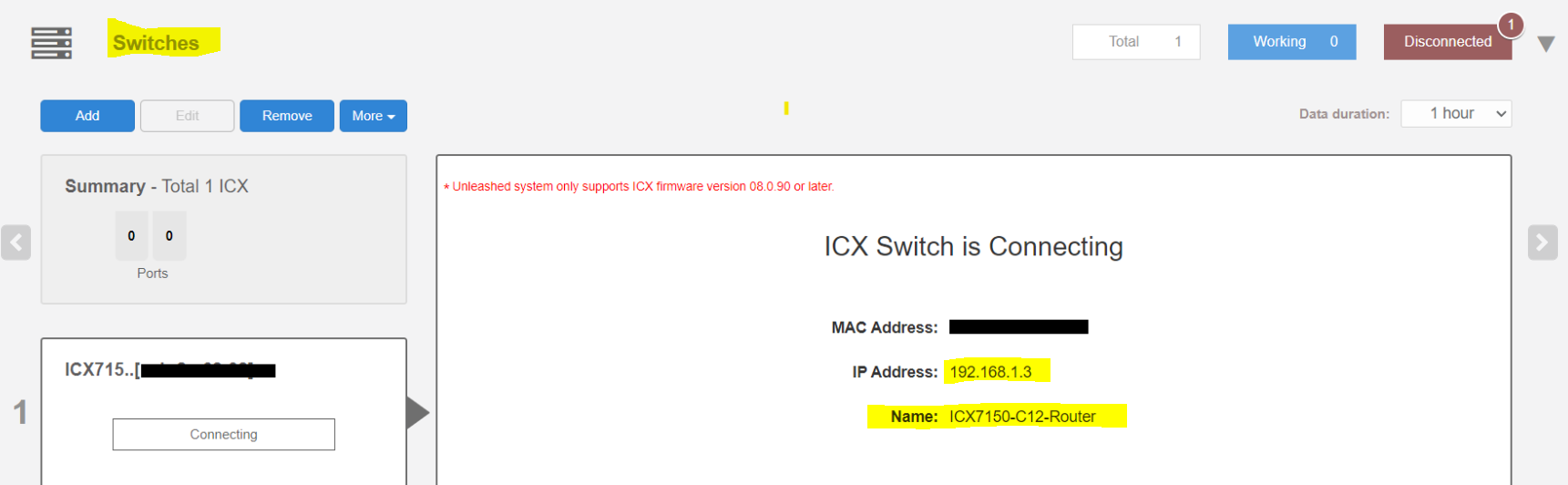

1: Find the IP address of the ICX7150 Switch
If you have access to the Unleashed control panel it may appear under the Switches TAP, here you can see that the IP address of the Switch will be 192.168.1.3, of course this will change.
If it is not shown, or you do not have access to the Unleashed control panel, please follow the following guide to find the IP address of the Switch the name may look like ICX7150-C12-router, normally the name should be switch, but we have the problem about the routing code, making the Switch boot from the routing partition(secondary).

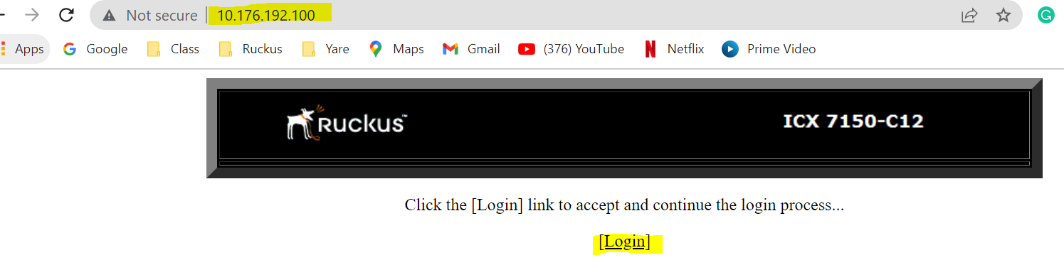

2: Now that you know the IP address of the Switch, in my case my IP address is 10.176.192.100, search for that IP address in the URL bar of your Web browser:

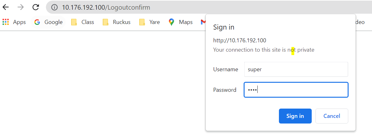

Hit login and the credentials must be
User: super
Password: sp-admin
Or test the combination

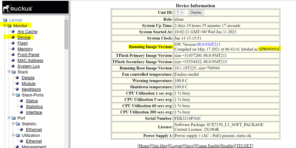

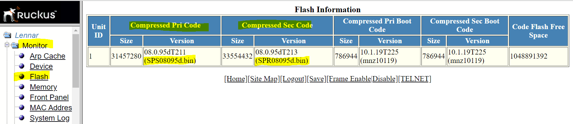

3: Now that you have access to the Switch, let's check what you have in flash, and from which code your Switch is booting.
A:Check what you have in the flash:
click on Monitor on the left > Flash > Flash Information
B:Check from which partition are you booting:
click on Monitor on the left >device
Note:Your primary flash code will start with SPS (switching code) and the secondary with SPR (routing code), in the next step we are going to boot from the partition that has the code starting with SPS, which must be primary, however this can change, also as you can see in my example, my secondary partition have the code SPR08095 and in the second screenshot it displayed I am booting from the code SPR08095, so I am booting from the secondary partition with the routing code SPR.

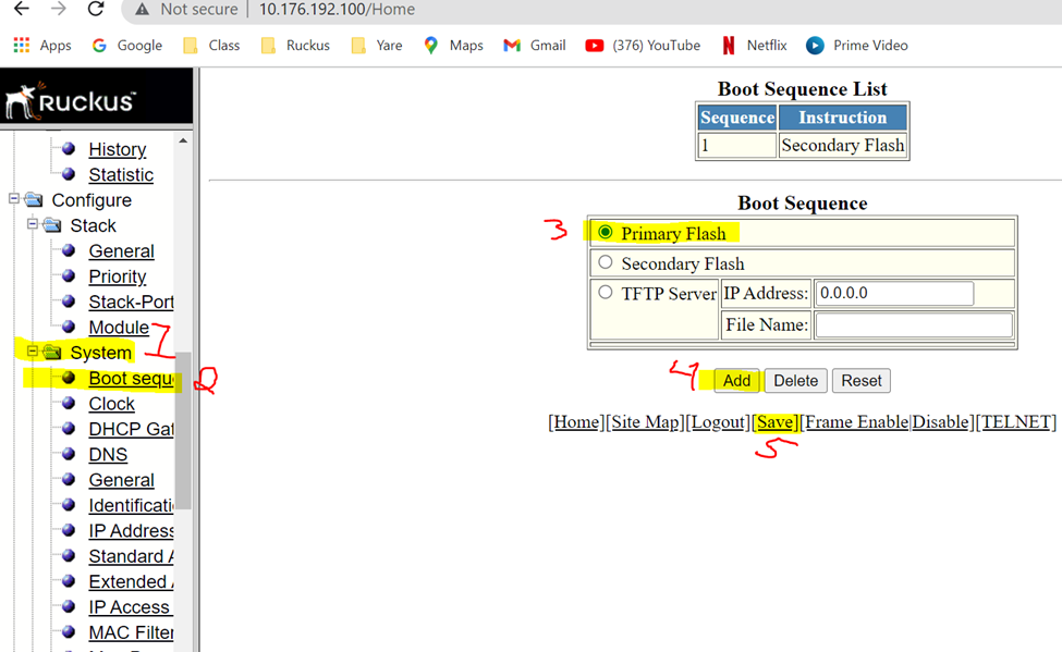

4: Let's fix the issue, please follow the following steps to fix the issue, forcing the Switch to boot from the primary partition containing the SPS (switching code).
Configure left>System>Boot sequence>Select primary flash >ADD>Save>yes
When it comes back this time, the Switch should boot from its primary partitions.
Note: if you got an error message that Boot sequence already exists., hit delete first and follow up the steps back.

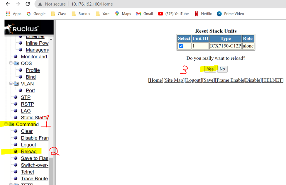

-Now let’s complete the process by reloading the Switch:
Command>Reload>yes
