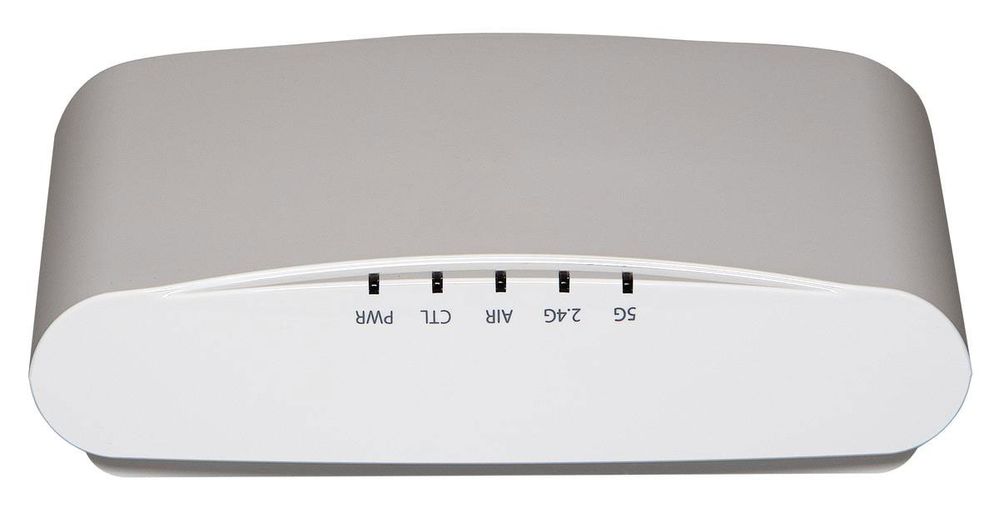

One of the main issues I have is that the lights on the wifi boosters that normally show up while it’s connected aren’t there. It’s as if it’s not even on. Not even the power light that normally shows up is on
Can you tell us which lights are not coming up correctly
Here is the guide the meaning : https://docs.commscope.com/bundle/unleashed-200.9-onlinehelp/page/GUID-19D4261B-D10B-4DE3-B63A-3498F80103D0.html
None of them are on. It’s all just blank.
