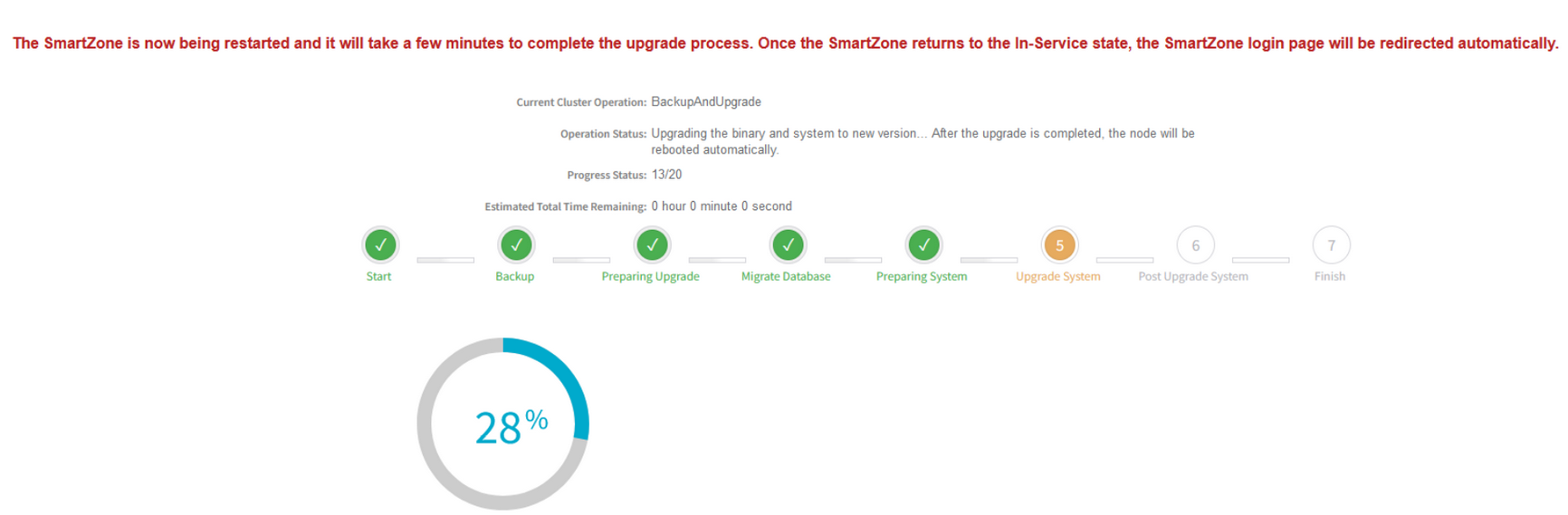

Issue Details: In this case, one of our customers was trying to upgrade v-SZ-H from 6.0 Release to 6.1 and the upgrade was stuck at 28% /upgrading system.

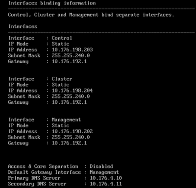

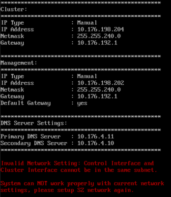

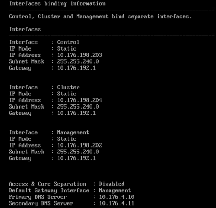

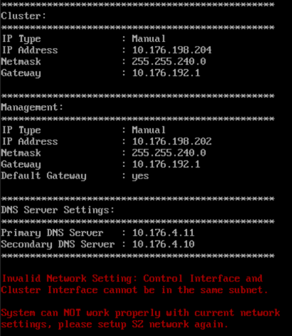

We could not ping the v-SZ instance after this state and must get into the v-SZ's VM console to find out what is wrong. We noticed the v/SZ had all three interfaces in the same Layer-2 Subnet/VLAN.
In 6.1 version, we have added a check to verify if all the interfaces are in same subnet, and if they are, v/SZ would not allow us creating an instance and an error will be triggered:
