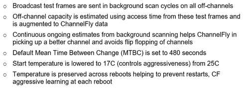

It may also be worth knowing that Channel Fly version 2 is coming out, which will bring significant improvements to an already a great way of improving throughput.
john_d
Valued Contributor II
Whoa! Tell us more 🙂
Image_ images_messages_5f91c46d135b77e247a7fa4e_790e1562d7bbe44bf407ce2a96e780ca_RackMultipart201601211727011w9-f4fd149d-0c4a-4bf9-ab42-01a6541a0f27-205352016.png1453336924
