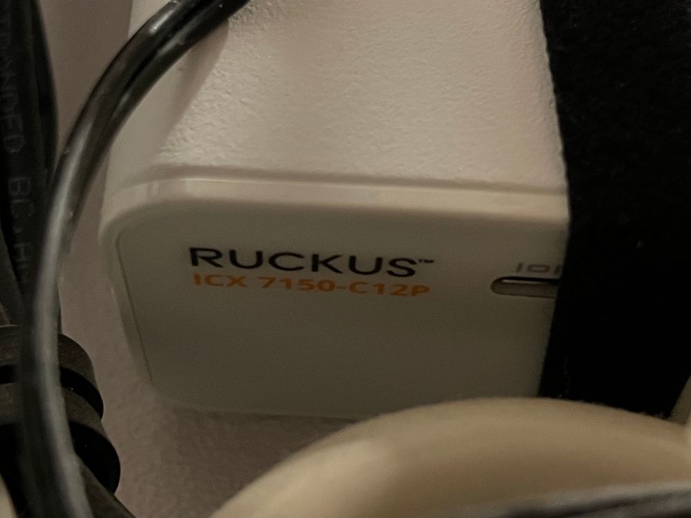

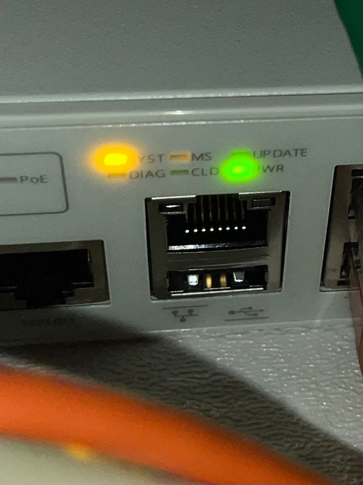

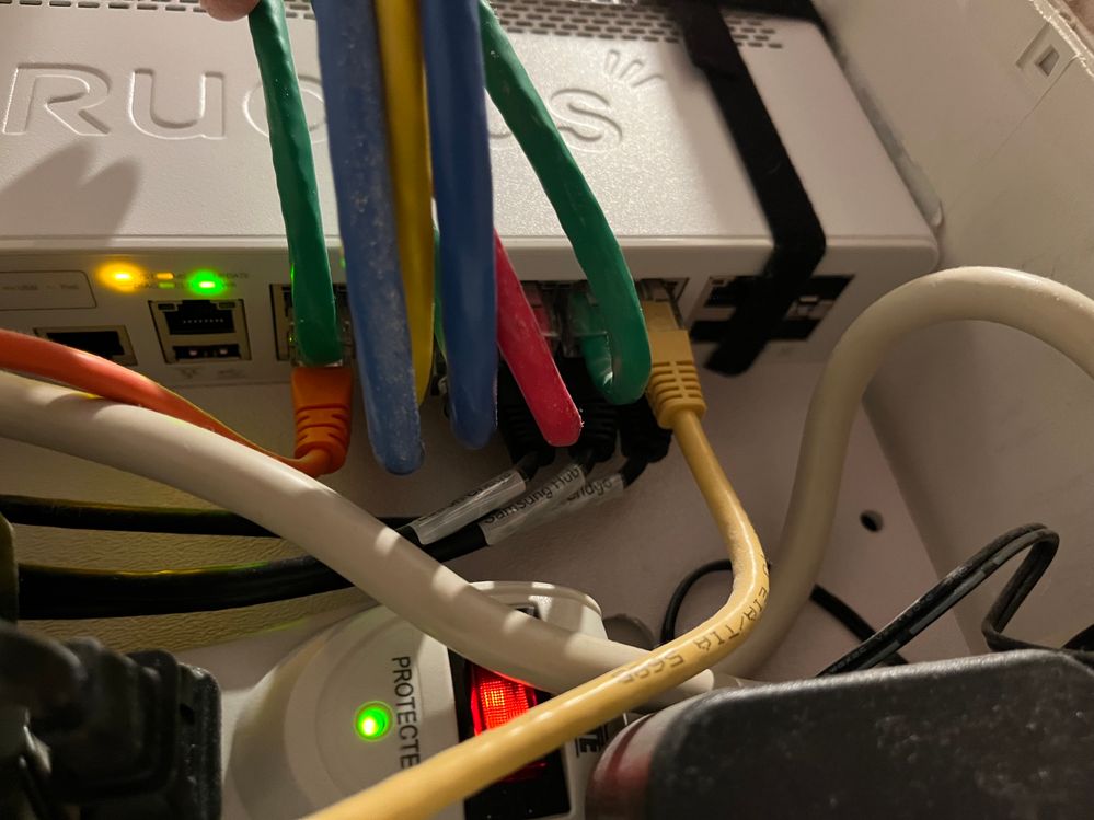

See the photos. I have an ICX 7150-C12P with two access points. There are no lights on either access point.The power light on the switch is green; the SYS light is amber.The system has been operational for more than two years before this incident.IMPORTANT: If I have to reset my network settings, I need to know how to do this, too.

Hi @rocket73h Basically, due to the power outage/ power spike, the switch went to a state that we call ‘boot mode’ that is not able to boot up properly.
