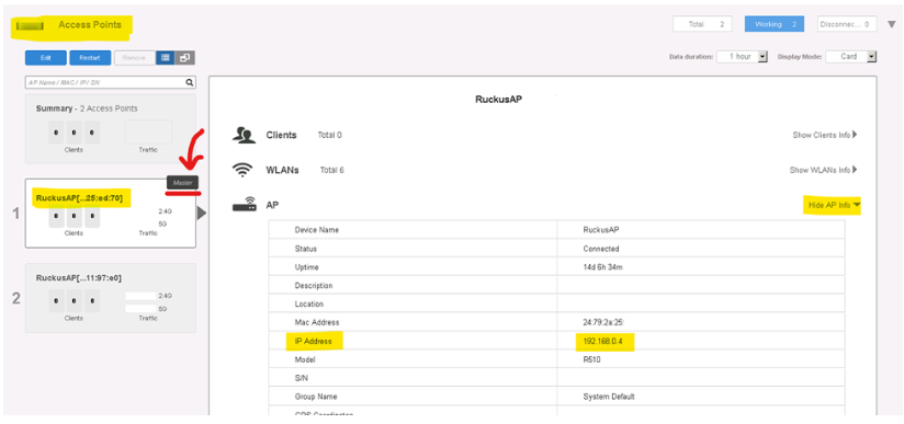

If you haven’t tried Accessing Unleashed on a web browser via the IP address of the Access Points, could you please try to find the Master IP address of the Access Point and try to check it on a browser? Please refer to the below guide to find the IP address.
You should see the below Unleashed dashboard after finding the IP Address of the AP. Try to log in
Refer to the below screenshot to know your MASTER IP Address on the Web Unleashed system.

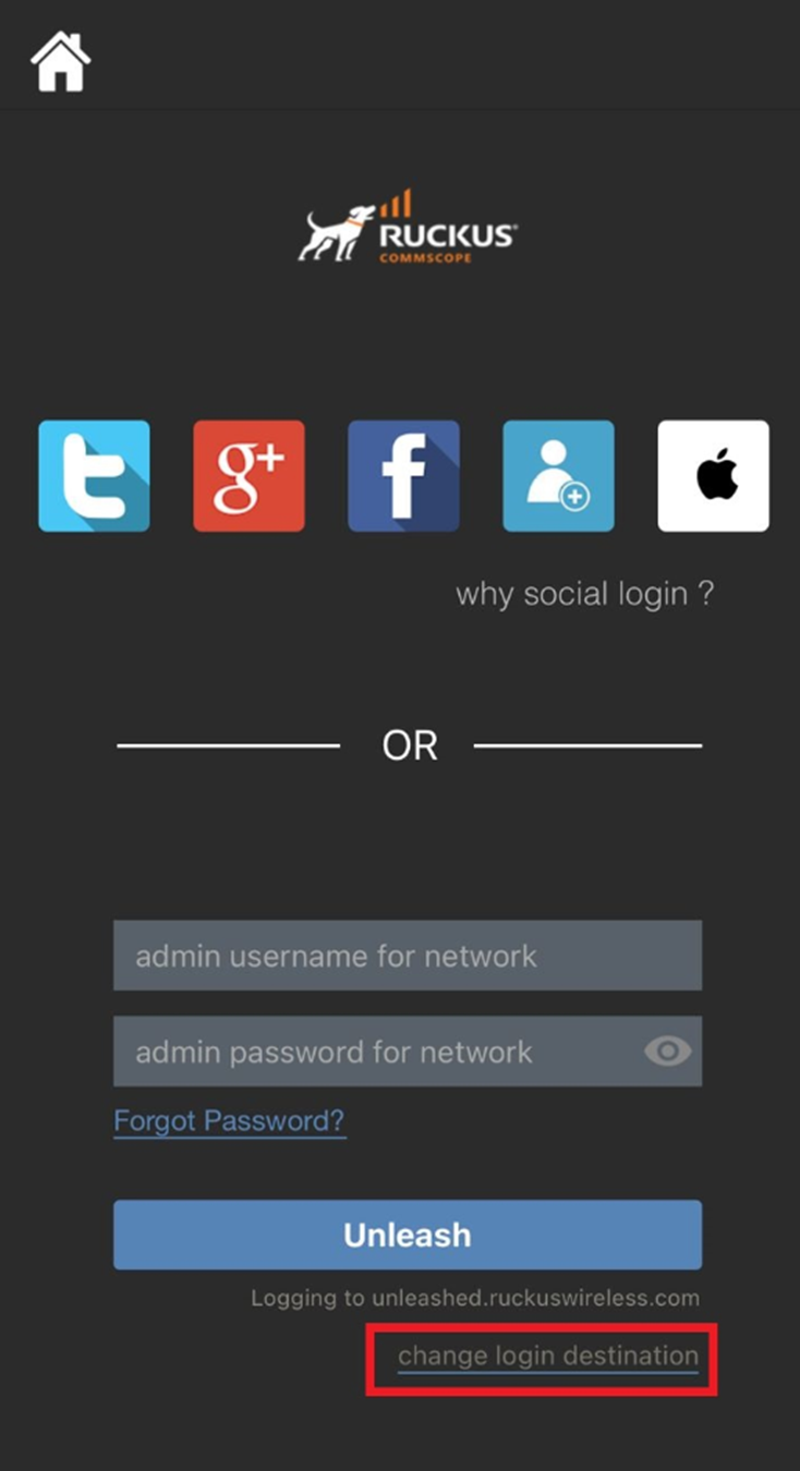

Once you find and can log in via the IP Address of the Unleashed Master Access Point, please try the below steps.
1. Make sure you are connected to the RUCKUS Access Point Wi-Fi Network.
2. Click on ‘change login destination’. (Please refer to the below screenshot)

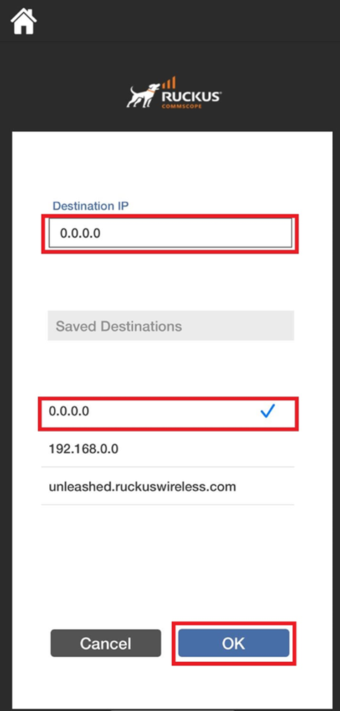

3. Put your Unleashed MASTER Access Point IP Address as ‘Destination IP’ and save it. (Please refer to the below screenshot and 0.0.0.0 is just an example)
4. Now try to log in to Unleashed App using your credentials.
Please follow ALL 4 STEPS as explained above.
