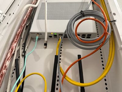

After noticing the access points were not being powered, I realized that the switch’s PoE was not functioning, with green power light and amber system light.

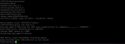

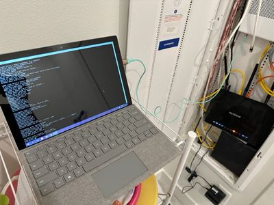

Attempting to reset/restart just had amber blinking lights for hours.. I did follow the instructions found here, used both usb-c, and mgmt port with usb-ethernet cables. I did see that boot files were deleted. But at the point where I would need to verify the connection with ping, all with return with message that it’s not alive..
Is there any other way to load boot files/re-image the unbrick the switch?
