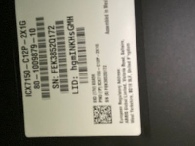

Please share a Picture showing the light status of the Switch as shown in the above picture.
Lennar Home Community.
The reply will not allow me to attach an image so you have an email I can send it to? There is orange for SYST GREEN FOR PwR
