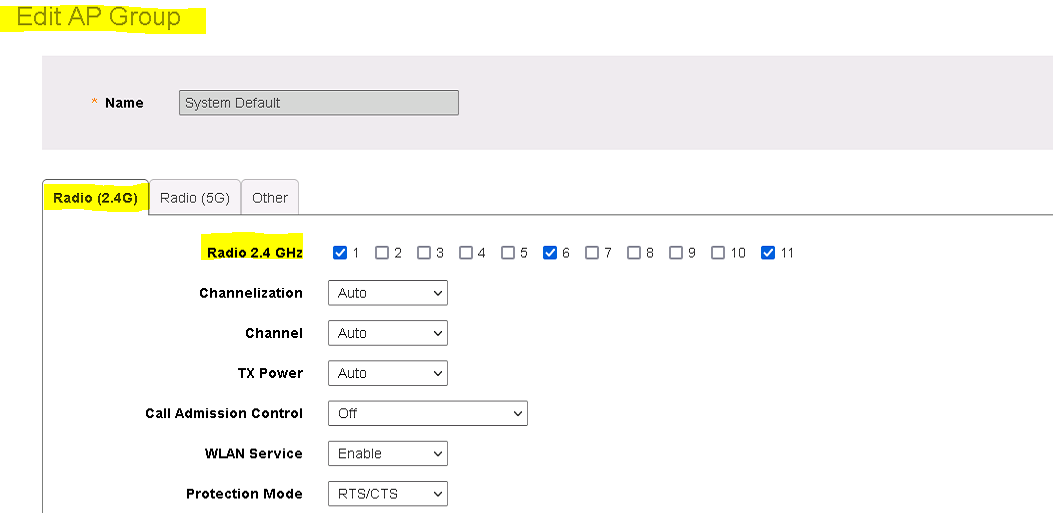

1: select the recommended channels
From Unleashed Dashboard page: unleashed.ruckuswireless.com
Tap Access Point>Edit> Radio 2.4 GHz>uncheck all channel except for 1,6 and 11

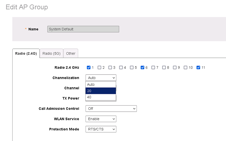

2: Change the channelization
Tap Access Point>Edit> Radio 2.4 GHz>Channelization>choose between auto,20 or 40
20 lower range of coverage it’s the best option to avoid interference
40 Only use it if your end devices are far away from the Access Point, for example you have one AP for a two-floor house.

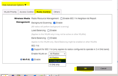

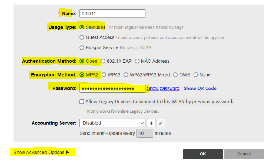

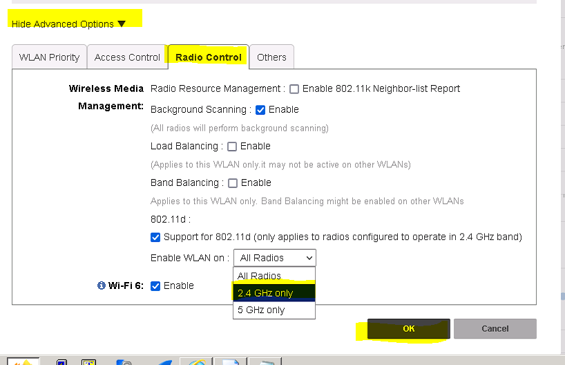

3: Create separate SSID with the 2.4 GHz signal only
This will help to control the devices that you want to connect to the 2.4 GHz signal only such cameras
Legacy devices or any device which is not capable to run 5 GHz signal

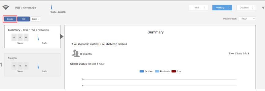

Tap Wi-Fi Networks>Create>fill all the data>show advance options>Radios Control>Enable WLAN on dropdown menu>choose 2.4 GHz only>OK
