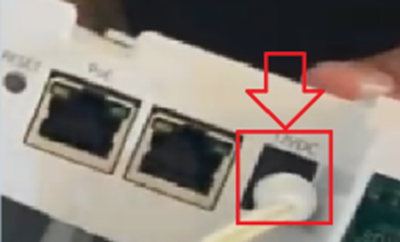

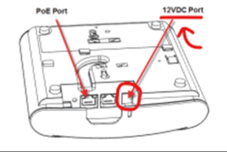

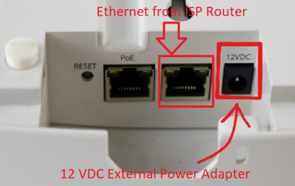

Could you please try connecting the affected Access Point to an external power 12 VDC adapter and check it separately without connecting to the Switch PoE port cable? (Please refer to the below screenshot). Usually, you will find the 12 VDC adapter connected to your ISP’s (Internet Service Provider’s) Router/Modem-Router combo device.
Once connected try to perform the factory reset of the Access Point as described in the below guide.

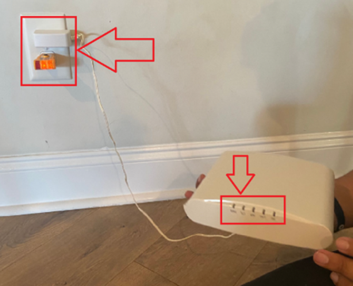

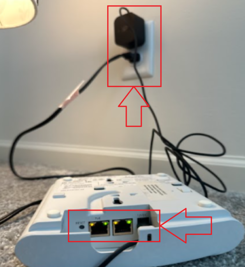

We kindly request that you connect your RUCKUS R510 Access Point (AP) one by one to a functional power outlet and share both pictures and a single video showcasing the light status, the 12 VDC External power adapter connected to the AP, and its connection to a working power outlet. Please refer to the example pictures provided below for guidance.
For the video upload, we have created a designated link for your convenience. You can access it via the following link: (Refer to the EXAMPLE VIDEOS from this drive link)
1. Show the plug of the RUCKUS Access Point being connected to a working outlet.
2. Simultaneously, display the light status on the Access Point.
If you have any questions or need further clarification, please don't hesitate to reach out.
I have uploaded the pictures and video, let me know if you need anything
Hi @kayakrd20 ,
Thank you for sharing the requested PICTURES and a VIDEO.
Based on the troubleshooting done, your RUCKUS R510 AP is not powering up even after connecting it to working power outlet, and when plugged in, gives solid red light. However, the failure persists. This AP unit Should be RMA (Return Merchandise Authorization) in simple words replacing it.
