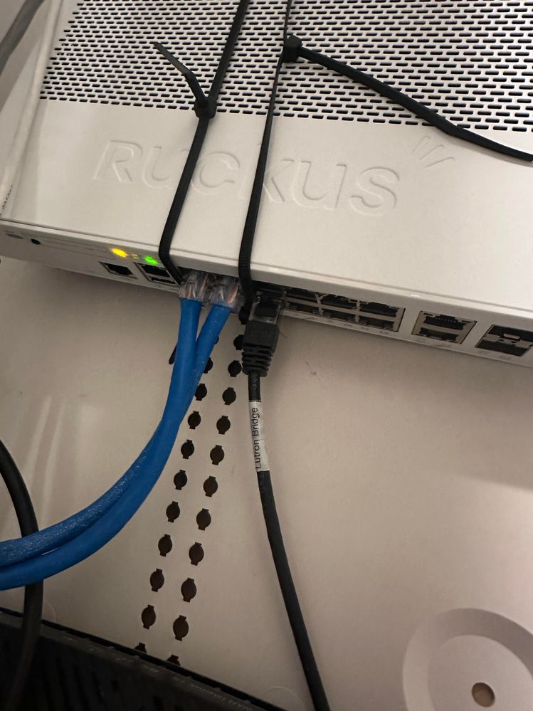

Here is a photo of the switch. It seems as if given this has been a reoccurring issue over many years, I have done everything and followed the tutorials as well. I am seeking to escalate this and just send this one back to have a manufacture warranty replace this item.
I have followed this and it still keeps happening. /kb/articles/4-fixing-ruckus-switch-with-an-amber-orange-light-on-syst-green-light-on-pwr-no-lights-on-aps
Resetting this is not an efficient way to troubleshoot after so many issues (from previous posts) The right thing and 98% of electronics sometimes just need to be replaced instead of resetting it.

Thank you for your response and for keeping us updated.
I would like to clarify that this forum operates on a best-effort basis, and as such, we do not have formal escalation policies in place.
As per company guidelines, RMA/replacement coverage does not extend to software-related issues or instances where the recommended troubleshooting steps have not been attempted.
I understand that your switch is currently stuck in boot mode, with the Amber/Yellow SYST LED. If a hard reset has not resolved the issue, the next step would be to perform a Software Recovery on the switch.
You can find detailed instructions for the Software Recovery process in the following link, which I am sharing again for your convenience:
Should you encounter any difficulties during the recovery process, please do not hesitate to reach out, and I will be happy to assist further.
