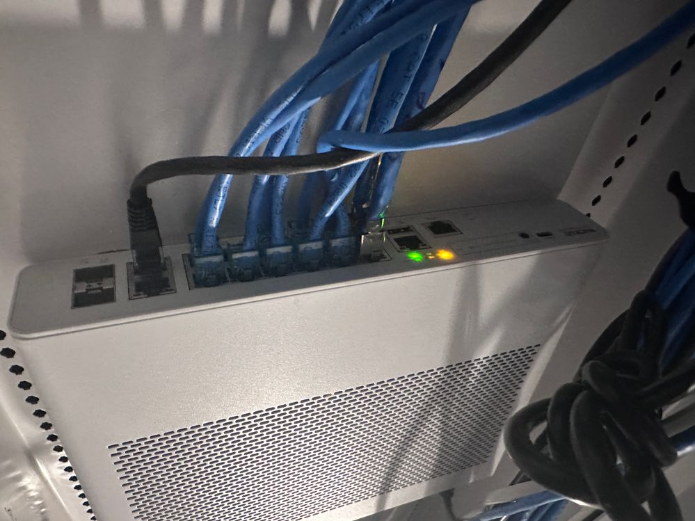

I am not sure what has happened over night other than it rained, but I have a Back-UPS connected to the switch to prevent power outage issues as I had an issue on the switch within the first 6 months due to a power outage.  It is a Lennar home that has the ICX-7150-C12P switch with three R510 APs connected to an AT&T Fiber Modem (BGW320-500).
Internet is connected via C1 port. I have pulled the power on the switch and powered back on but the router is not seeing the switch when I connect to any ports including the C1 and C2 ports. When i connect to the Out-of-band management port (RJ-45) with 2 LEDs, I get connection to the router. What is needed to get my switch and AP connected. I really don't want to reset the switch as it will take a lot of configuration to get it all set back up.
My suspicion is the switch is faulty.

Hello @Jota31 ,
As per the case description, I understand that your RUCKUS setup is not working after the power outage
On your switch while it's plugged into the outlet, do you see any lights on? (Amber or green) Please let us know which lights are on. (Please refer to the below picture and share a picture of the same, showing the light status and the FULL Switch panel cable connections to the Switch ports)

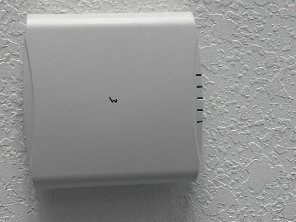

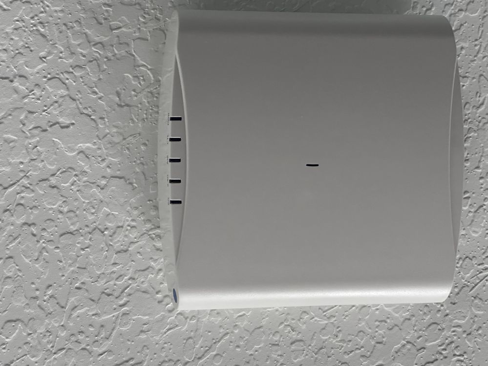

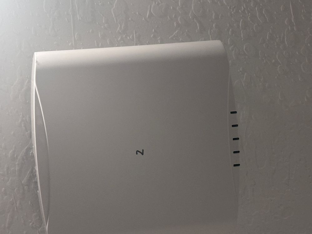

Here are the requested images.
SwitchSwitchAP 3AP 3AP 2AP 2AP 1AP 1
Hello @Jota31 ,
From the response you shared, I understand that the status lights on the Switch is Amber and the PWR light is Green, which means that the Switch is stuck in a boot mode
Please follow the below RUCKUS Lennar Knowledge base self-help article which will help you to fix the issue when the Switch is in boot mode.
https://community.ruckuswireless.com/t5/RUCKUS-Lennar-Support-Knowledge/Fixing-RUCKUS-Switch-with-an...
Please follow the process as explained in the article and let me know if you have any queries in this regard.
