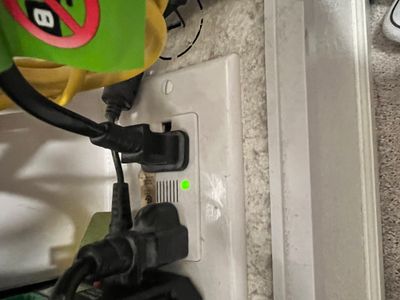

Had a power outage last night and ruckus is not powering up. Have already done a power cycle. Please help.
Hello @Sandav ,
As per the case description, I understand that your RUCKUS Switch is not turning on after the power outage.
Also, you have mentioned that you have done a power cycle on the Switch.
Could you please plug your ICX-7150-C12P Switch into a working power outlet and send us PICTURES and VIDEO of it showing the light status, and a cord connected to the Switch and a working power outlet? Please refer to the below pictures as an example.

Hi @Sandav
Thank you for providing the information and the screenshot. Based on the screenshot, the amber light on the "SYST" indicates that the RUCKUS ICX-7150-C12P Switch appears to be stuck in boot mode.
To address this issue, please refer to the following RUCKUS Lennar Knowledge Base article for troubleshooting guidance:
Fixing RUCKUS Switch with an Amber/Orange Light on "SYST"
Please follow the instructions in the article, and let me know if you require any further assistance during the process.
