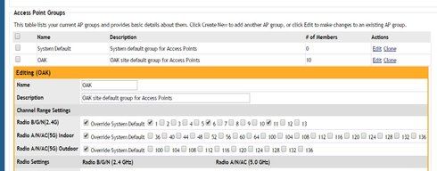

As per Alan R suggestion...screenshot attached:
Note: this as a ZD1125 so might look a little different in your case
go to
Access Points
Configure
tick override
untick all the channels in 5Ghz.
should do it.

tried that and it wont apply it. says choose radio channel. if I add one channel it lets me apply it.
unknown
Less than perfect kludge: choose one channel and then set the TX Power option below at min! Not off but very weak.
