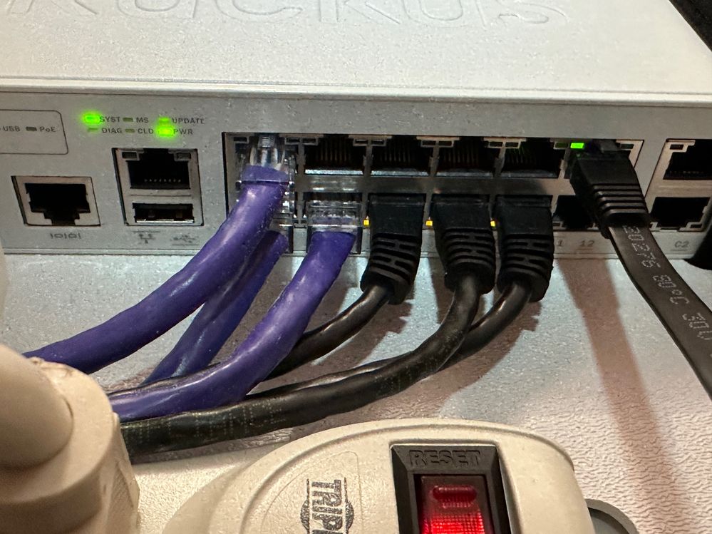

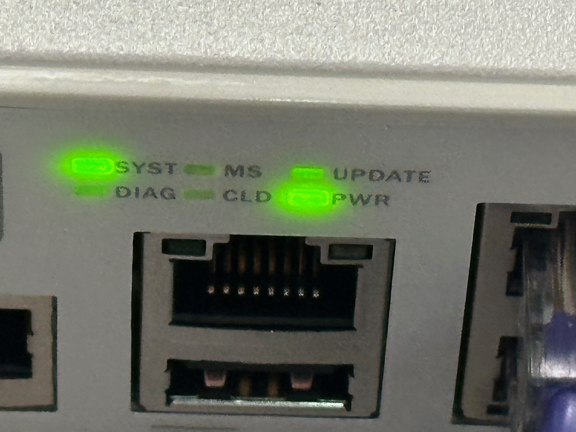

I have 3 wireless access points (purple wires) connected to a Ruckus ICX 7150-C12P switch. It has been working since my Lennar home was built in 2018, until today. The switch SYST and PWR lights are green but the access points have no power. In addition to the 3 access points (purple wires), there are 3 other lines (black wires) connected to the switch for Samsung, Kevo and Lutron. Those 3 (black wires) are working and show amber lights at the switch ports. The 3 access point wire ports (purple wires) on the switch show no lights. I have read in many of the forums to reset the switch. I have reset it a handful of times with no results. Resetting the access points doesn't do anything because they have no power. What's next?
