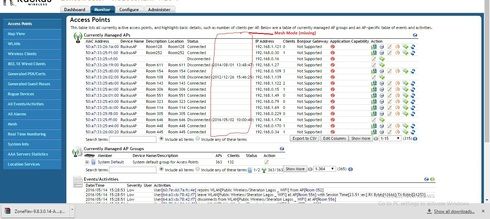

1. The two T301n could not mesh wirelessly, we realized that on the -- -- webpage, that is completely missing
We believe have seen the problem, we upgraded from firmware version 9.4 to 9.8.3.0.14. The aim is to include new devices like T301n, R700 and R600. Now upgrade is running successfully but now we want to mesh T301n(s), we enabled the mesh but on the Monitor AP view, "Mesh Mode" seems hidden or not available.
Please how do we include this Mesh feature of ZD3000 v9.8.3.0.14 successfully? We really need this wireless mesh connection
