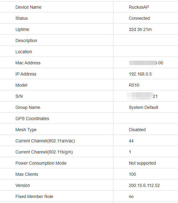

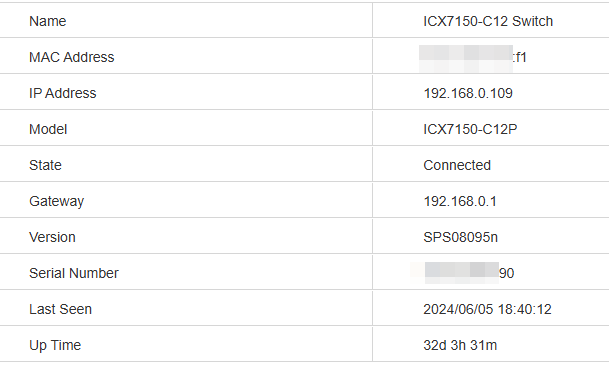

1. Could you please provide the current running versions (SPS or SPR on Switch) of your RUCKUS ICX-7150-C12P Switch and R510 Access Points? We kindly ask for screenshots displaying this information for better assessment.

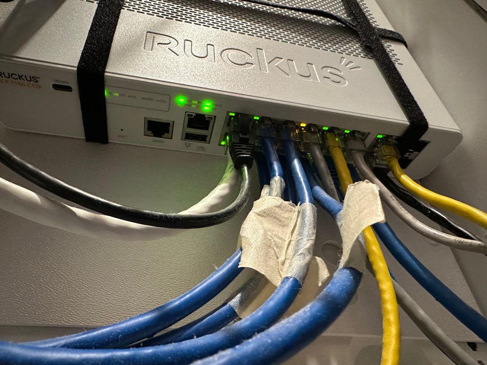

3. When your switch is connected to the outlet, do you observe any illuminated lights (amber or green)? Kindly specify which lights are currently active. Additionally, please help with a photo displaying the light status and the complete switch panel, including cable connections to the switch ports.

We kindly request images of your ICX-7150-C12P Switch, showcasing the status of the lights and the cable connections to the switch ports.
Prior to uploading the photos, please log in to your RUCKUS account to facilitate the upload process.

1. attached images

3. Yes, switch lights are working (included picture)

Upon reviewing the image you shared, it seems that the ethernet cable originating from the ISP’s Router or Modem/Router combo is connected to an incorrect port on the Switch panel.
For optimal functionality, the ethernet cable should be plugged into any one of the 1-12 ports, as depicted in the provided screenshot. We kindly request that you disconnect the ethernet cable from its current port and reinsert it into the appropriate port. Following this adjustment, please reboot the system by unplugging and replugging it from the power outlet. Subsequently, attempt to check the stability of internet connection via the Access Points.
Please acknowledge receipt of this message and feel free to reach out should you require further clarification or assistance.
Your patience and cooperation are greatly appreciated.
Hello, neither of those two cables highlighted in red are coming from my router. The top left black cable is coming from my router/ISP which is either port #1 or 2. But I’ve gone ahead and moved those cables as suggested. After reboot I’m still experiencing the same issue of intermittent 5Ghz service

Could you please log into the Unleashed system and share a screenshot displaying the following information?
Kindly share the requested screenshot at your earliest convenience. Should you have any questions or require further clarification, please do not hesitate to reach out.
