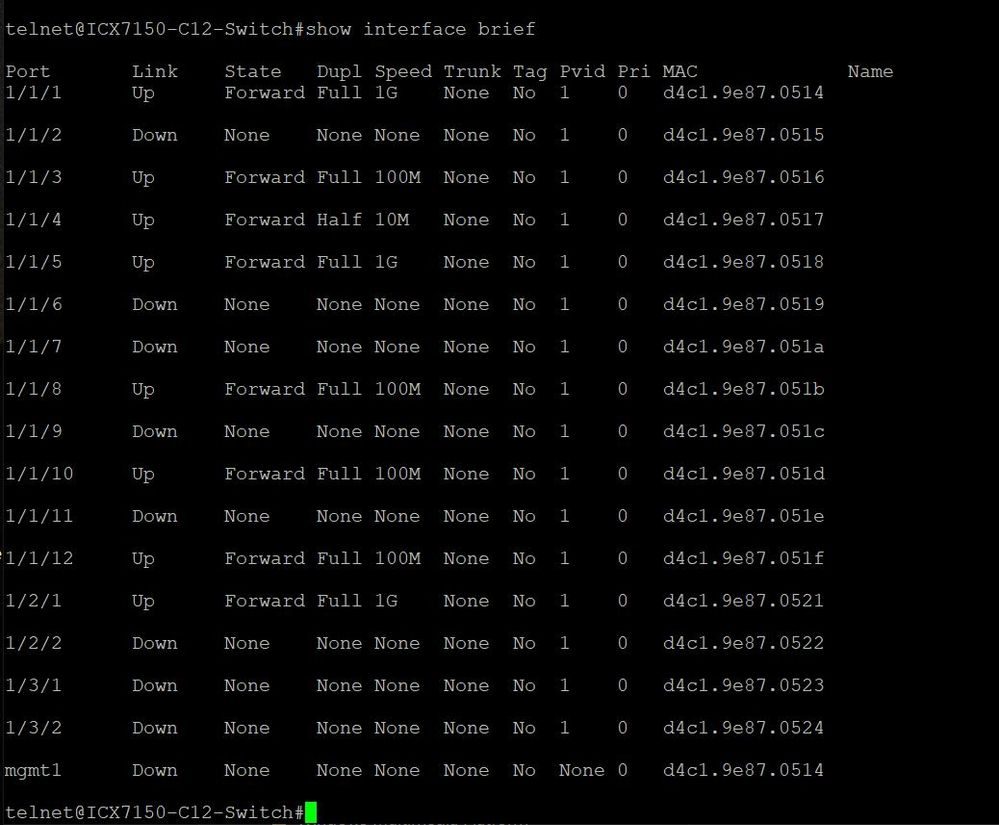

- My ISP recently upgraded my internet speed to 500 Mbps --- which I can now achieve when connected directly to my cable modem, but the Ruckus system seems to be internally restricting my speed to about 250 Mbps. I had heard that this could potentially be caused by a corrupted setting in the ICS switch?

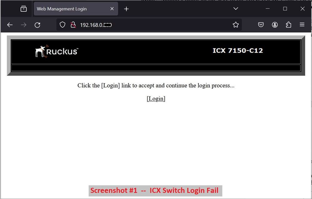

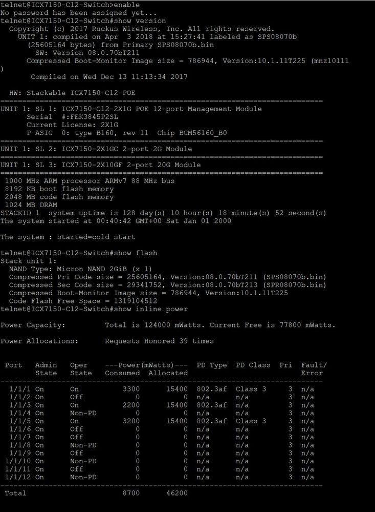

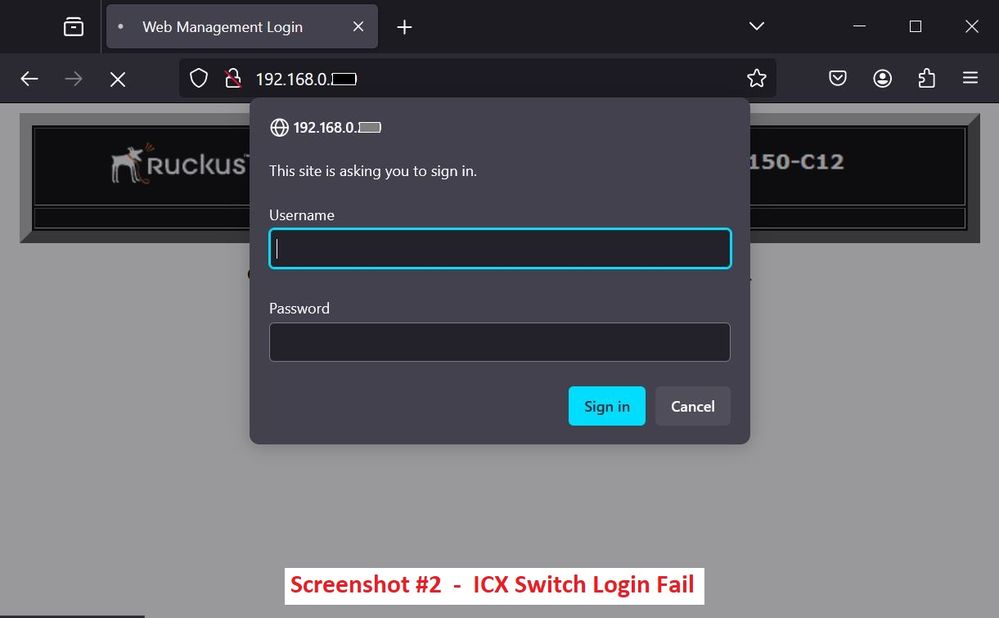

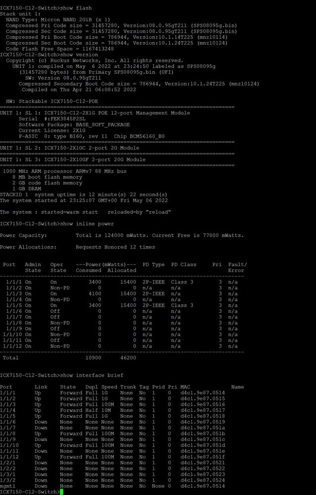

The ICX Switch is going to be difficult as well. I am unable to log-in to the Switch at all from the web browser interface --- the original installer must have thoughtfully changed the admin log-in (very helpful of them), and none of the username/password combos that I could find in the Ruckus support forums worked either. Following some other advice on the Ruckus forums, I purchased a long USB-A to USB-C cable, and downloaded PuTTY --- and I was able to gain access to the ICX Switch using this method. This showed me that the Switch firmware was version 08.0.70bT211 --- which, like the APs, appears to be far from current. But I have had worse luck finding specific information about how to deal with the Switch on the Ruckus forums.

- Before I start messing around with the Switch, how can I set myself up a log-in username/password on the Switch so that I could access it with administrator privileges via the web browser interface?

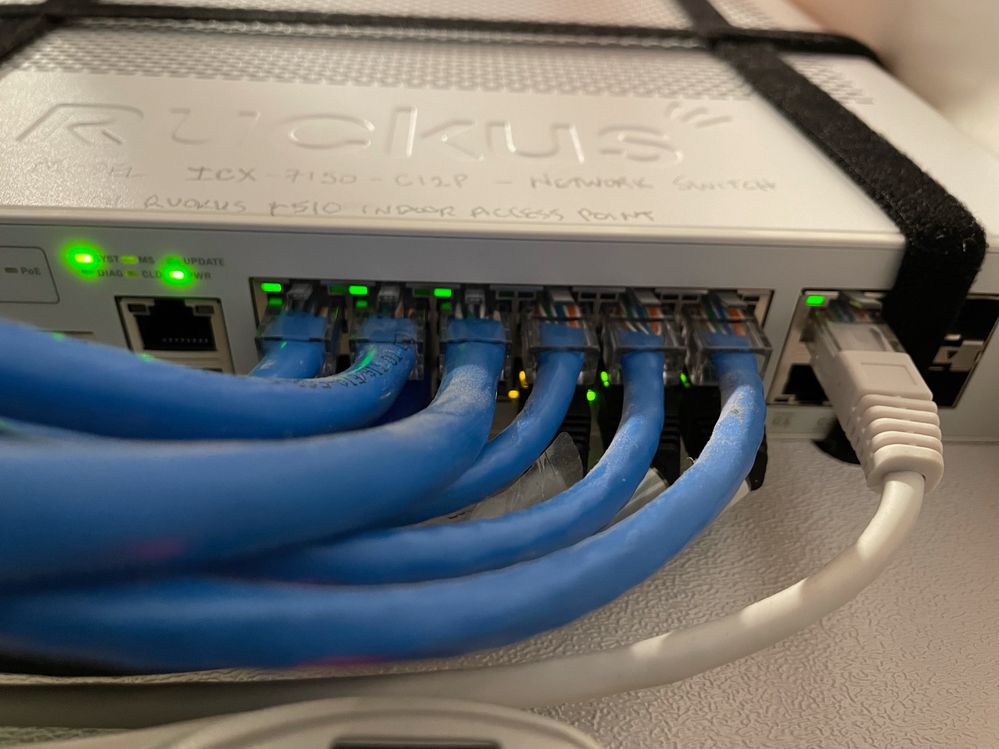

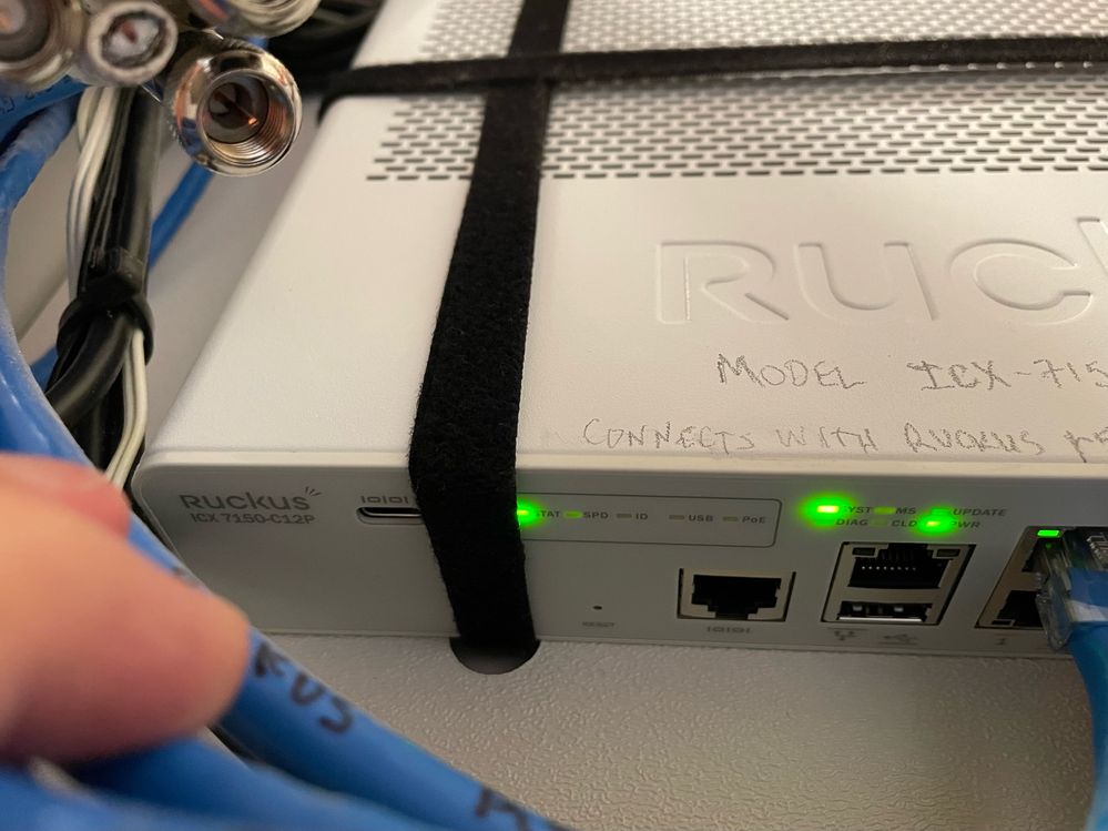

I've attached a few pics at the end here, some of the same as requested in other posts, just to try to jump start some of this. (Pictures of the Switch connections & lights; screenshots while connected to the Switch via PuTTY)

Switch - PuTTY - 1
Switch - PuTTY - 2
Switch - Connections/Lights - 1
Switch - Connections/Lights - 2
