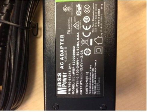

I am trying to get an spare power adapter for ZD1205 and was looking the specs to get a right adapter.. this is where i hit the huddle
Technical datasheet says Output: 12V DC, 1A
Label on the bottom of ZD1205 reads: Output: 12V DC, 2A
I know ZD1k and ZD1100 worked on Output: 12V DC, 1A
Which one to go for? Can someone confirm?

The ZD1200 power supply is not the same as ZD1100/ZD1000.

Product Marketing has answered and will be updating the ZD1200 data sheet to reflect the correct power requirements, input 110-240V AC, output 12v DC 2A.
We use a single manufacturing supplier with a different power connector than the ZD1100/1000.
If you need a replacement, please contact your VAR who may have stock, or can process an RMA.

The PSU for ZD1200 is on the May price list, just released:
902-1169-US00
Spares of US Power Adapter for ZoneFlex R710, ZoneDirector
1200- quantity of 1
$20
