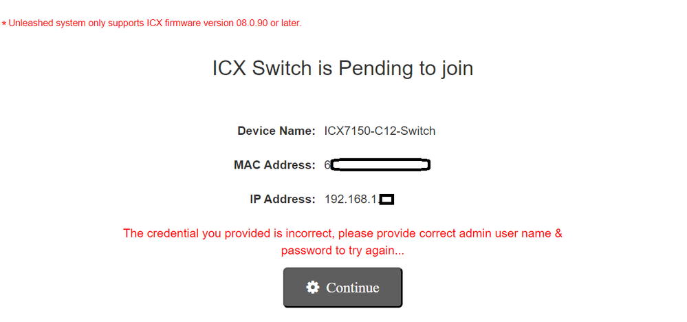

But the switch doesn't seem to join the Unleashed network. Both the APs show connected and display information
On the Unleashed UI, I see the Switch as "Pending" with the message
The credential you provided is incorrect, please provide correct admin user name & password to try again...
I'm assuming that a typical upgrade does not wipe out credentials?
How can I get past this state for the switch.
