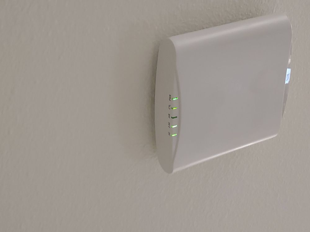

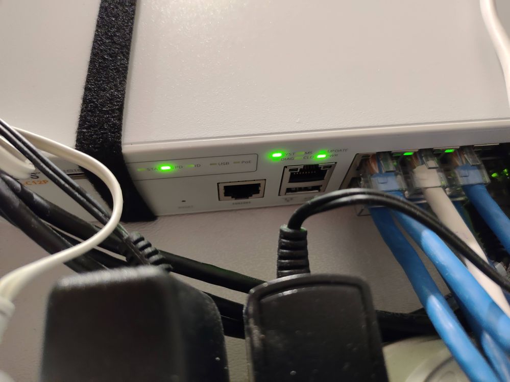

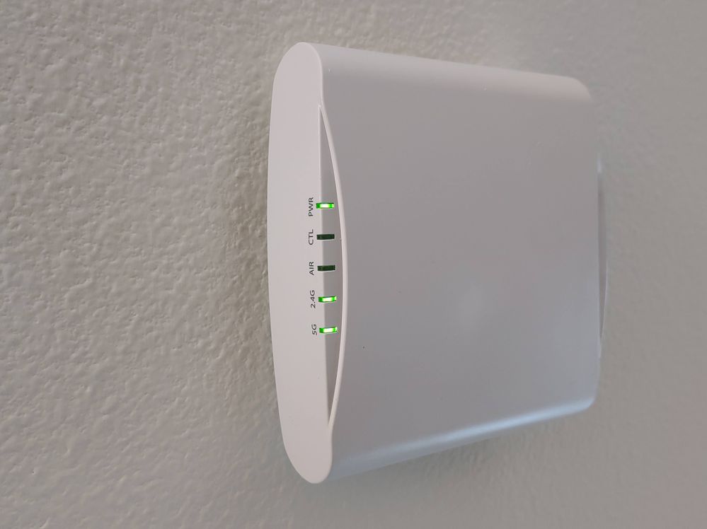

Hello,
I am a different user but am having similar issues to others. Heartbeat loss on both APs at the exact same time, every 12 hrs. Then they come back online a minute or two later at the same time. The issue started occurring about a month ago.
Here is what I have done:
- Set separate WLAN 5 Ghz and 2.4Ghz channels
- Increased background scan times from 20s to 300s to 600s, no difference.
- Set static IPs for the APs; did not make a difference so changed back to DHCP
Please let me know what else to look at.
Slave
Master
