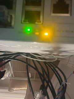

I’m not sure what to do HELP
Hi @Ladyk1016
Greetings of the day,
Based on your description, it seems that your switch one green and one yellow light, which means that your switch is stuck in boot mode.
Please try following the below steps to solve the issue.
1- Try to disconnect from the Power outlet the ICX- 7150 and reconnect it.
2- Try to press the reset button using a paper click or a small stick
If this step doesn't work, we need to perform a software recovery.
Here is the quick guide to perform software recovery.
If the resetting process doesn't work, we need to perform a software recovery.
https://community.ruckuswireless.com/t5/RUCKUS-Support-for-Lennar-Homes/How-to-perform-a-Software-recovery-on-an-ICX7150-switch/m-p/47483
Note: after fixing the issue of the Switch been stuck in boot mode, please perform an upgrade to the code 08095g UFI and upgrade both partitions with the switching code file named SPS08095gufi.bin, so perform the software recovery using the code 08090k with the upgrade image file named SPS08090k.bin, then when the switch is back to normal upgrade to the file SPS08095gufi.bin for both partitions primary and secondary.
https://community.ruckuswireless.com/t5/RUCKUS-Support-for-Lennar-Homes/How-to-Upgrade-a-Switch-ICX-7150-C12P-using-a-USB-flash-drive/td-p/46781
https://community.ruckuswireless.com/t5/RUCKUS-Support-for-Lennar-Homes/How-to-Upgrade-a-Switch-ICX-7150-C12P-via-TFTP/m-p/47187
https://community.ruckuswireless.com/t5/RUCKUS-Support-for-Lennar-Homes/How-to-perform-an-Upgrade-via-Web-GUI-ICX7150-Switch/td-p/48200
