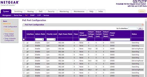

I have a Netgear GS752TP running R500s (max power 10.5W so don't need "at") using both "at" and "af" POE ports.
Notes:
I didn't require anything beyond default settings.
Running latest firmware for switch (6.0.1.16).
unknown
screenshot of LLDP
unknown
also LLDP port settings
unknown
ok, and which ports on the screenshot do you have R710 connected to?
unknown
Sorry. To be clear I have R500s attached to 3, 7, 10 - which covers both power options on the switch.
The R500 is a lower power device than R710 so only needs "af".
This was to give you a view of what is available on switch and to that R500 works off off boths kinds of POE port on default settings. If I had an R710 I'd put it on and see what happened!

For what it's worth, this is the switch PoE status page (at the time I took this, 3 of the R710's were connected to ports g2 - g4), with port g1 - g8 all theoretically able to deliver full PoE+ 802.3at power, and all connected APs are correctly identified as Class 4.
