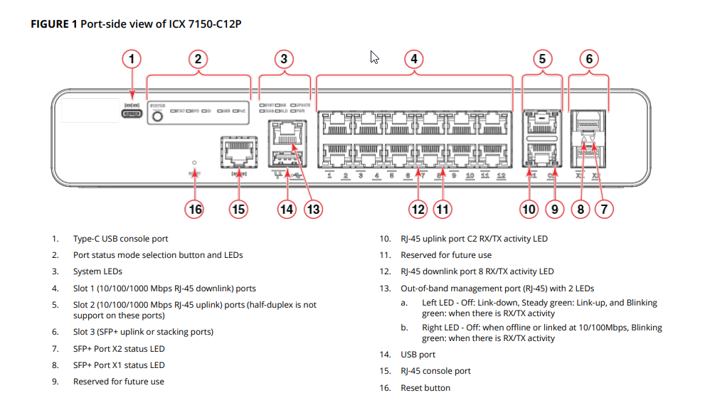

My house is having the same issue as Ronnie. We have our Fios router connected to the network port above the usb port, and there is a solid and blinking green light above it. We have cables in ports 1-4 and they have no lights. I assume these four cables correspond to the four ceiling routers in my house. What next?
Hi Ach,
The port above the USB port is what we call an out of band management port, and is mainly used for managing the switch.
Can you please check, did you put the cable in NR 13 as shown in the picture below?
If so, please disconnect that cable and put it in one of the ports that are labeled NR 4 in the above picture (those are a block of 12 ports any of them will be good)
Then see if all is working again.

Ok I moved the cable from NR 13 to NR 4. No lights are coming on still, and my ceiling routers still have no power.
