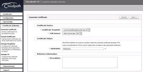

this is the Generate Certificate feature from Cloudpath ES

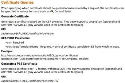

in the Cloudpath's API document in page 6, mentioned that we can use the Generate Certificate feature directly from API as follow
which is supposed to be
https://MYWEBCLOUDPATH/admin/api/MYAPIKEY/certificate/generate?csr=AUTOGENERATE&certificateTemplateName=username@anggota.polri.go.id&username=80060661in the document mentioned that CSR is required,
what should i fill the CSR if the generate certificate that i want to be generated is using Auto-Generated CSR configuration?
