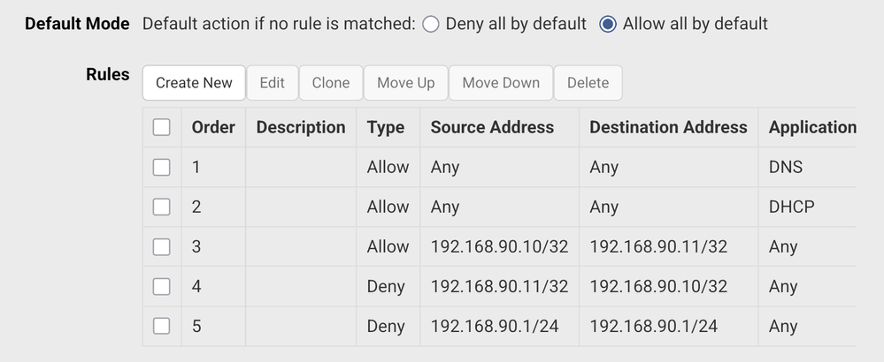

I have a wifi where I want to isolate all devices except 2, that need to be able to communicate with each other. The "Wireless Client Isolation" options in the "Others" tab of a WLAN will not work since they isolate everything or they permit every device to access the two devices that should only talk to each other.
Therefore i hoped that I could make use of an Layer 3/4 ACL in the "Access Control" tab.
in addition to the two predefined rules (DNS and DHCP) I added
Allow 192.168.90.10/32 to 192.168.90.11/32 with every option set to "Any"
Allow 192.168.90.11/32 to 192.168.90.10/32 with every option set to "Any"
Deny 192.168.90.1/24 to 192.168.90.1/24 with every option set to "Any"
With this setting in place I can still ping every device from every other device on the WLAN.
If I enable "Wireless Client Isolation" in addition to the ACL, even the two allowed devices stop communicating, to this option seems to have a higher priority that the ACL.
All the testing I have done seem to show that Layer 3/4 ACLs are not working. So my questions are:
- How do ACL and Wireless client isolation interact with each other?
- How are ACLs supposed to work?
- How can i isolate all clients except specific ones?
