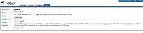

When trying to upgrade my ZD1000 firmware from version 3.0.3.0(yes very old) to the latest, it just says "uploading..." after I click on the firmware file that I want to upload. I don't think it takes 30 minutes to push the firmware to the device.

Unfortunately you can't upgrade directly. You need to do quite a few stepwise upgrades to move up from a version that old. Please contact support so they can help you through this - we probably don't even have your next valid release posted to the support site.

Open a case with us and ask for Michael Brado. I'm an old-timer and might
still have some of the old ZD1000 firmware images. You may not be able to
upgrade higher than 7.1 however, if you have one of the very early/initial ZD1ks.
