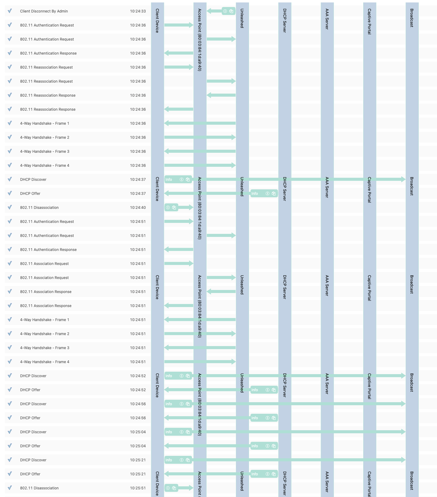

Following is a screen cap from Unleashed client troubleshooting. It shows one of the Leviton switches after it has lost connection and is trying to reconnect, but cannot. This pattern continues forever and is exactly the same for Unleashed 200.16.0.402, 200.17.7.0.139, 200.17.7.0.152.

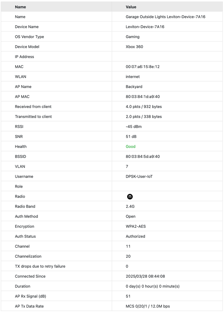

Following is a screen cap from Unleashed show details for the same device in the Unleashed client troubleshooting screen cap above. This shows the device during the DHCP negotiation period seen above. The device appears to be unable to acquire an IP address and eventually disassociates itself. I've made no changes to the clients, network, or Unleashed configuration while testing. The only variable has been the Unleashed firmware version that is deployed.
