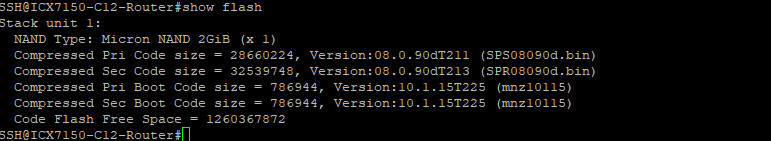

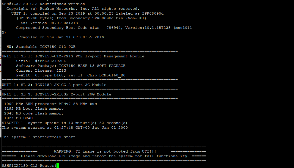

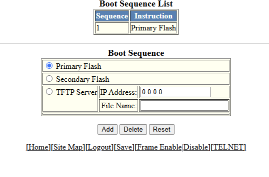

So I am running into problem where my switch is stuck as pending. I tried switching the code through the CLI and changing the boot sequence to primary in the web interface but nothing is working. I also tried upgrading the switch but get an error saying bootrom is an invalid input. Below are my screenshots.
Show flash:
Show version:

Boot sequence set to primary in web interface:
