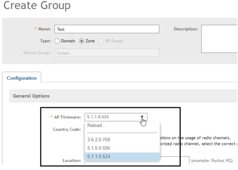

Answer: vSZ allows us to create multiple zones and in case you have upgraded the vSZ (as you did), it allows us to choose different firmware versions for each zone.
Image_ images_messages_5f91c485135b77e247acea52_f4003fb9b04be4b76d75a6ba9b707f31_RackMultipart201906069906314hv-aab04bc9-ed73-4913-bbe8-f44e73197583-410047518.png1559831760
I have checked internally and there are no such issues reported of AP reboot due to power cycle. So best way to investigate is to move these AP's to the older version and monitor their behavior. And if they run stable, then you can open a support case to investigate this further.
