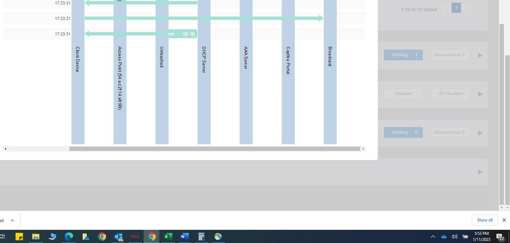

I clicked on trouble shooting and I picked the honey well device, it originally received “Reason: (code 6) Received class2 frame from non-auth STA” and then continued to try and trouble shoot is continues to ask me if I want to extend trouble shooting for the past 30 minutes. I am not familiar with Ruckus troubleshooting and need help figuring out what is wrong. I am not able to work using the internet due to this issue and then issue has been going on for weeks.

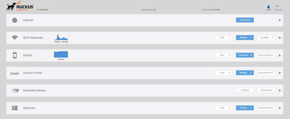

I am accessing the unleashed app via apple mobile and Ipad. Remote management is enabled. I click to test the mobile app notification. I see the notification on my apple device but when I click on it goes blank. I refresh to go back into the app and I get the error "ensure this unleashed network has internet connection and remote management is enabled." I am able to access this app sometimes via these same apple devices and I am connected using the same wifi as the unleashed. I can log in via PC With no issues when I can get internet access.
I do notice when logging on via PC to the unleash dashboard that the internet shows disconnected when I select to trouble shoot a device but the internet quickly turns back on.

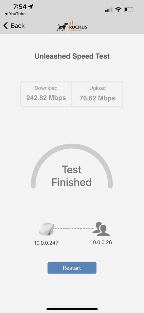

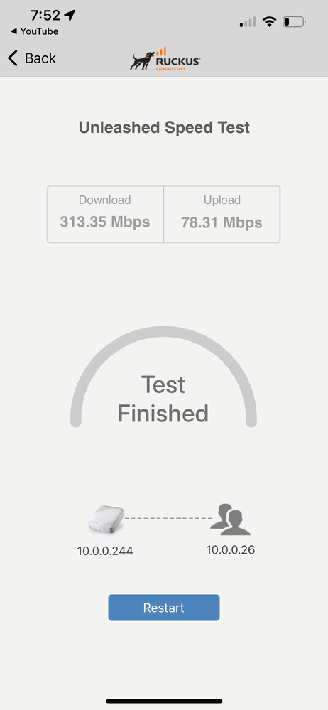

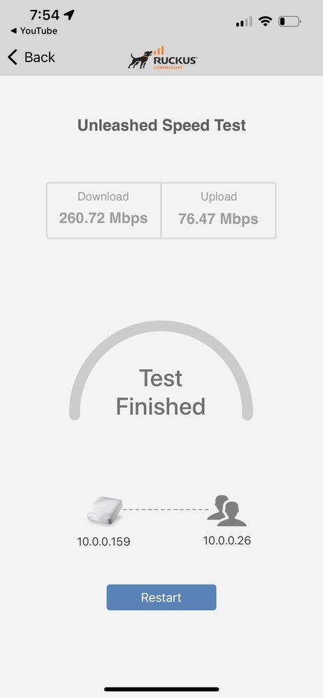

Today I Also showed the gateway and DNS had an x in the dashboard but when I click refresh it came back on. I am noticing when I am connected to the internet I am getting very slow speeds. Screen shot attached.
I am not sure how to disable 802.11r and 802.11k for the honeywell thermostat. How would I do this? For now I have taken this device off of the unleash network and it is working fine.
Reason code 6 yes I was able to check IP and ping gateway and DNS. No issues just reason code 6 for honeywell consistently and all other devices at times.
All my devices connect to the internet but the continuously disconnect saying there is no internet connection through the day or the speeds are very slow where internet searches are taking time to load or just freeze and I get an error message to check my connection.
