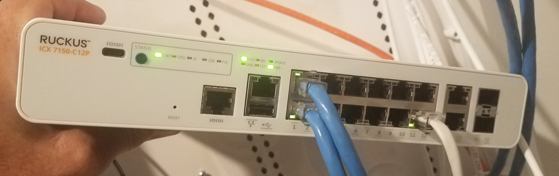

We recently experienced a brief power outage in our community, and since then, the Ruckus access points have become unstable. Despite all the access points showing green lights, occasionally the 5Mhz light will be yellow, we are encountering frequent internet interruptions and slow speeds. I have all WAN connections connected as suggested in other posts. On the RUCKUS ICX-7150-C12P switch all status lights are green except USB is yellow.

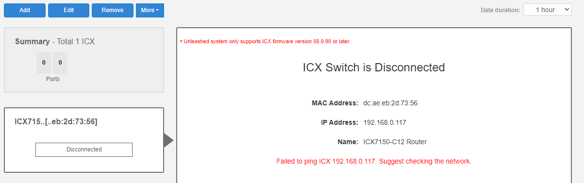

I also logged into the Ruckus Dashboard and see this:
I am not able to access this IP address: 192.168.0.117 via  browser, telnet, ssh and does not appear in "Advance IP Scanner" list of IP addresses.

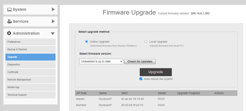

I believe I found the version information here:

Based on the information you have shared it seems like the internet issue is stable while you are connecting to the ISP router, but the issue persists while you are connecting to the access points or the switch, it looks like your Switch (ICX7150 Switch) may be booting from the secondary partition ( Note: Secondary partition contains the routing code)  which is causing the bad connectivity issues.

Note:  if you have access to the Unleashed Dashboard and the Switch can be seen from there, it may look like the following image, ICX7150-C12-Router instead of ICX7150-C12-Switch, now before starting the steps of the guide, I will advise you to cable the computer directly to the Switch, since you will have a better connectivity than if you connect via wireless.
